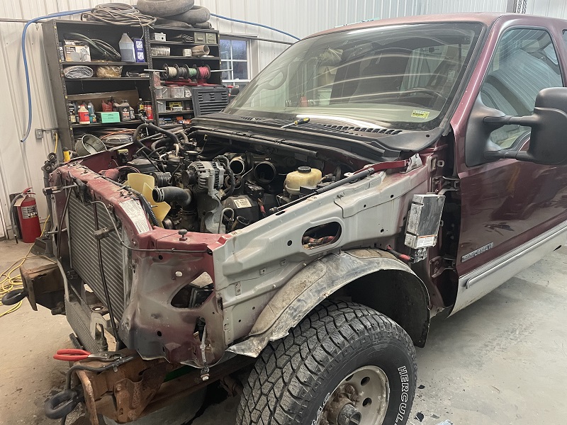

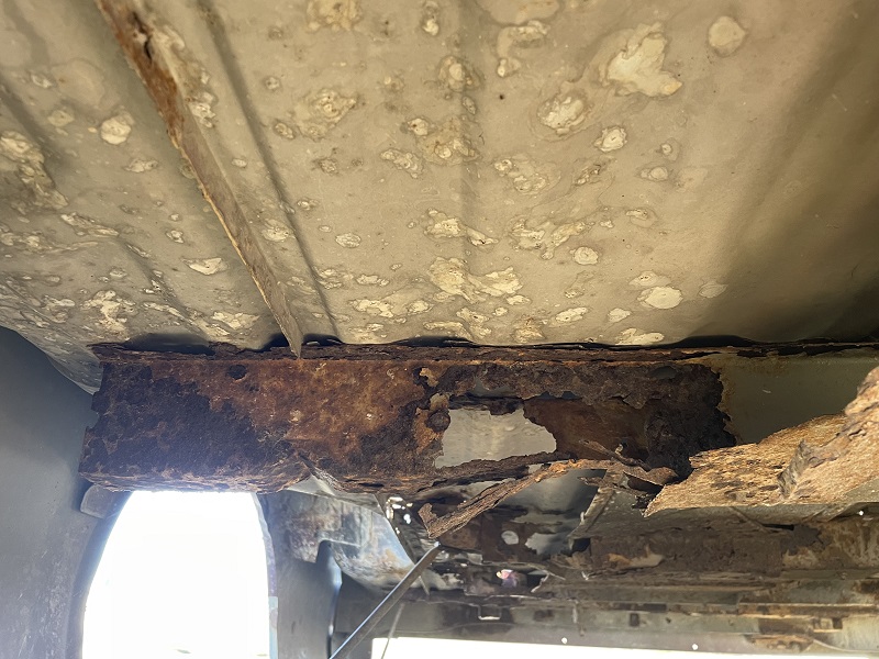

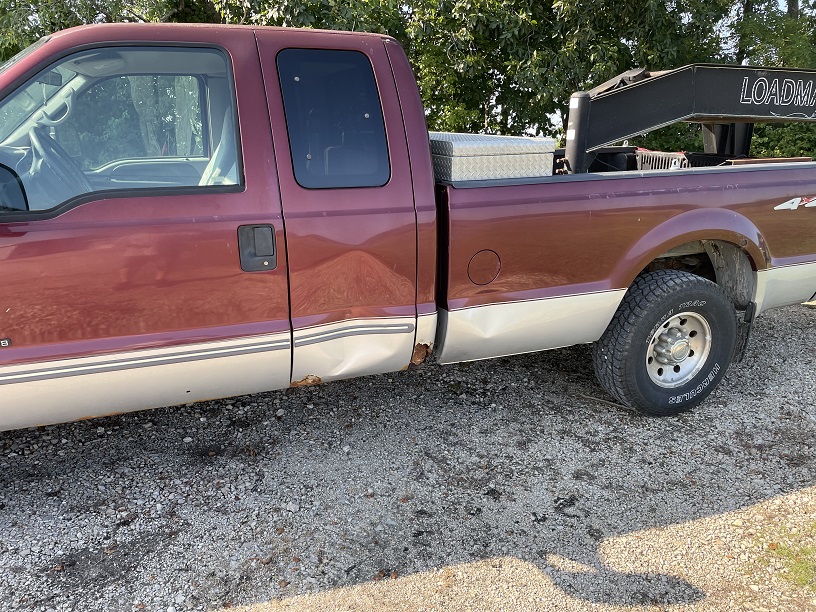

My ol Beater
ALL four doors are rotted from Inside, Bed to Frame supports are nearly completely rusted away, frame so far is showing solid.  R F Fender has a Tree Gnarl at front and both rusted at cab lower corner, rockers are SAD.  Upper Rear Door latches gave up last year., tail gate fell away from rust last year, was hanging on cables when caught it.
Been as good a machine as could have asked for.  7.3 is a boat anchor, is a hog in soft ground as front buries rapidly, but is worth the trouble.

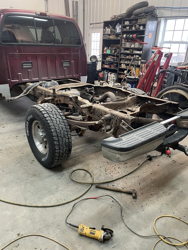

Points: 36778
Post Options Post Options   Thanks (0) Thanks(0)   Quote DMiller Quote  Post ReplyReply Direct Link To This Post Posted: 08 Jan 2024 at 10:11am

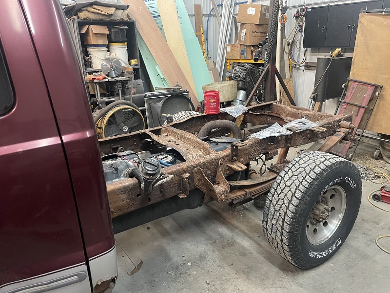

Current state, down to a few items to disconnect then go to cab mount bolts.
Will be dropping tank today or tomorrow to replace brake tubing behind it and to ready that section of frame for rust encapsulation paint.
Edited by DMiller - 08 Jan 2024 at 10:11am

I have tried to wire brush / clean and repaint the frame of a truck a few times.. Paint always started to rust thru in a couple years ... Several years ago i read an article about a DESALT process... They said it dont matter how many times you WASH the bottom of your truck with pressure washer and soap, there is ALWAYS a salt film left over imbedded into the steel frame. That starts the process of rusting again...... DOT in Wisc ( i think) was experimenting with a process to NEUTRALIZE the salt, after washing the frame with pressure washer... Conclusion was that if you do this, the PAINT will stick much better and LONG TERM the frame will hold up better... I have been using this for about 10 years when i do  touchup / paint repairs on the frames... ANYTHING that travels on the highway, has salt IMBEDDED into the steel  that needs cleaned prior to paint............. just a suggestion..
Points: 36778
Post Options Post Options   Thanks (0) Thanks(0)   Quote DMiller Quote  Post ReplyReply Direct Link To This Post Posted: 09 Jan 2024 at 4:24am
The product I have received is a Encapsulator body men use. Has a rust converter in the base that shuts down the process. Has to be oversprayed with a paint product but is noted to neutralize the process of corrosion. Just have to have the large chunky stuff off the surface.

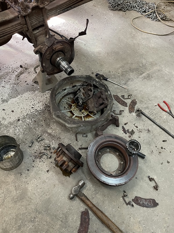

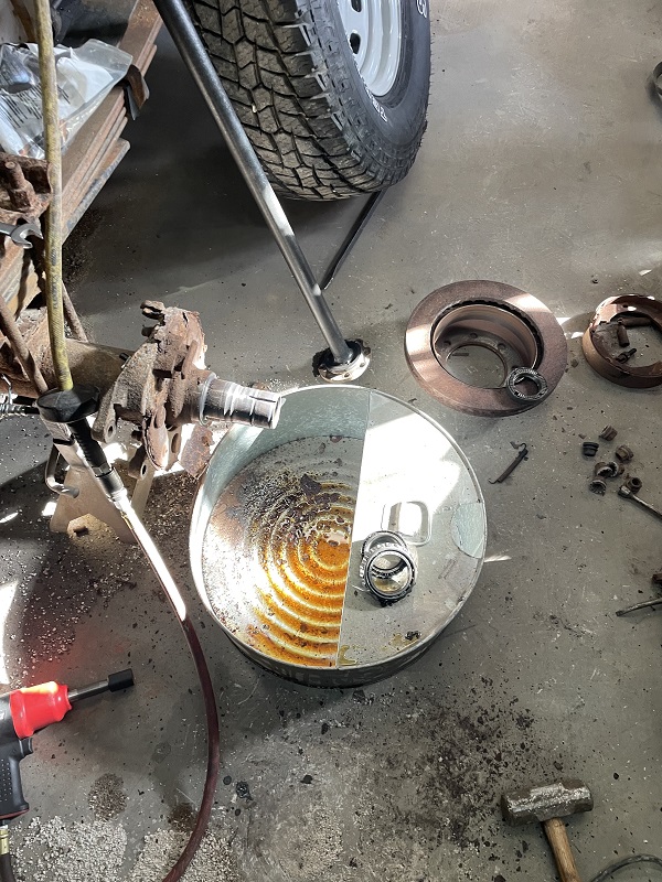

Deeper inspections costing me more, think gonna have to work on this with Eyes Closed.
Started removing rear brakes and hubs for P-Brake repairs, pads went to self destruct mode, rotors appear shot, pistons froze SOLID in calipers and as expected Hub Seals leaking.  TOUCHED Dust Shield, collapsed into piles of rust dust.  OH ME OH MY!!  $$$$ Keep Flashing!!
