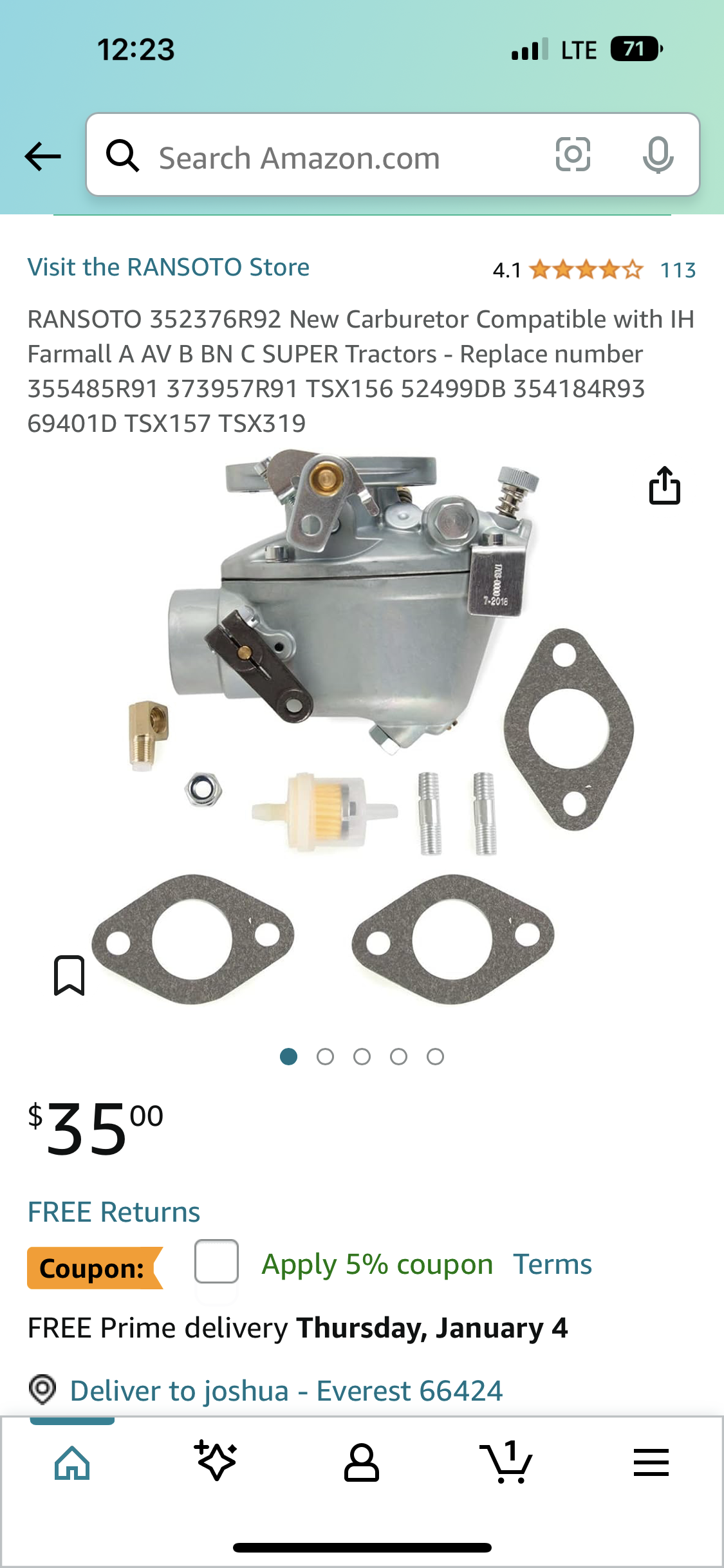

Anyone used one of these to replace a carb? I’ve taken mine off a few times and cleaned everything but still leaks fuel out the front. Engine was just broke free last weekend and cleaned the points up and got spark at all 4 plugs. Timed everything back up but seems as though fuel is my issue now.
Points: 5235
Post Options Post Options   Thanks (0) Thanks(0)   Quote PaulB Quote  Post ReplyReply Direct Link To This Post Posted: 27 Dec 2023 at 12:43pm
the throttle arm is wrong for an Allis Chalmers with a small block (B,C,CA,RC,116.125,138,149 or 160 engines). Do some research for the correct carburetor for what you are working on.

YES.. I installed on on a "B" last summer.. Had to take the throttle arm off and turn it upward and then solder back to the shaft. You got to make sure it does not drag the side of the block when mounted... Real close in that area...  Choke arm was OK, but needed adaptor to screw the push / pull rod to the arm..
The  B/ C motor is 125 cubic inches. My though was if you find a "aftermarket" that is for a 120- 135 inch motor it should be " close" .... that seemed to  work.... There are a few variations of the aftermarket carb.. look close.

You know the DISTANCE from the governor cross shaft behind the radiator, to the carb throttle arm  has to be set RIGHT for the governor to work... Your not going to have the NEW ARM exactly where the OLD ARM was located, so the ROD to the governor cross shaft will have to be BENT to get the proper operation.

Seems pretty straight forward, thanks for the info! If nothing else I’ll box it up and send it back. But 35 vs 400 is worth a try.

It works... just not PLUG and PLAY... If your willing to invest a couple hours for install, then adjustments, it seems to work fine..
the Farmall Carb you showed is for a 113 cubic inch motor.. about 10% smaller displacement than the "C"..... I choose one that was 10% BIGGER than the "C".... Probably same carb with a slightly bigger main jet, etc...
I think I’ll go with the one you shared, looks a little easier to “modify”. Thanks again!

How did you remove the arm to solder back in the up position? Is it just soldered on? Looks press riveted or something.

Yes, the arm has a square hole in it and fits over the square end of the shaft.. shaft sticks thru 1/16 inch and they MUSHROOM the end to hold it on... I just ground off the mushroom and pulled the arm off... flipped it over 180 degrees and put a drop of solder on the end...... the arm is not EXACTLY the right angle and not EXACTLY the right length so you have to adjust the governor rod for proper operation...
Another way to do it would be to make a NEW AREM from small strap, ( that is 50% longer).. lay on top of the OLD ARM, but pointing upward, then SOLDER the two together... ... again, dont get too close to the engine block or your arm will drag the block..
