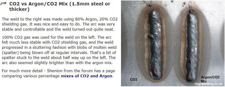

Have ran the Argon/CO2 blend here as seems as noted less spatter, and with shop doors open less shield drifting.

Post Options Post Options   Thanks (0) Thanks(0)   Quote steve(ill) Quote  Post ReplyReply Direct Link To This Post Posted: 17 Dec 2023 at 9:18am
Here is a photo off the internet.. I cant give a PERSONAL opinion, since i have never used the MIX.... I have used CO2 for 25 years..

Have used 75/25 for years , tried some straight CO2 and spatter was problem .
