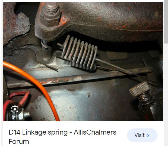

Do you have the anti-surge spring installed and hooked up correctly? My D15 will surge when cold until I pull the throttle wide open then it smoothes out.

Joe... it surges because the carburetor is not matched exactly to the motor.. On the FACTORY carb, you can adjust the screws to get "better".. but many still need the SURGE SPRING....... If you install an AFTERMARKET carb, there is a better chance that it is not matched as well to the motor and will surely need the spring.
If you use a random spring, your going to have to play with the length and tension to get it right... You can get an idea by how hard you have to HOLD the rod with your finger to calm down the surge..
