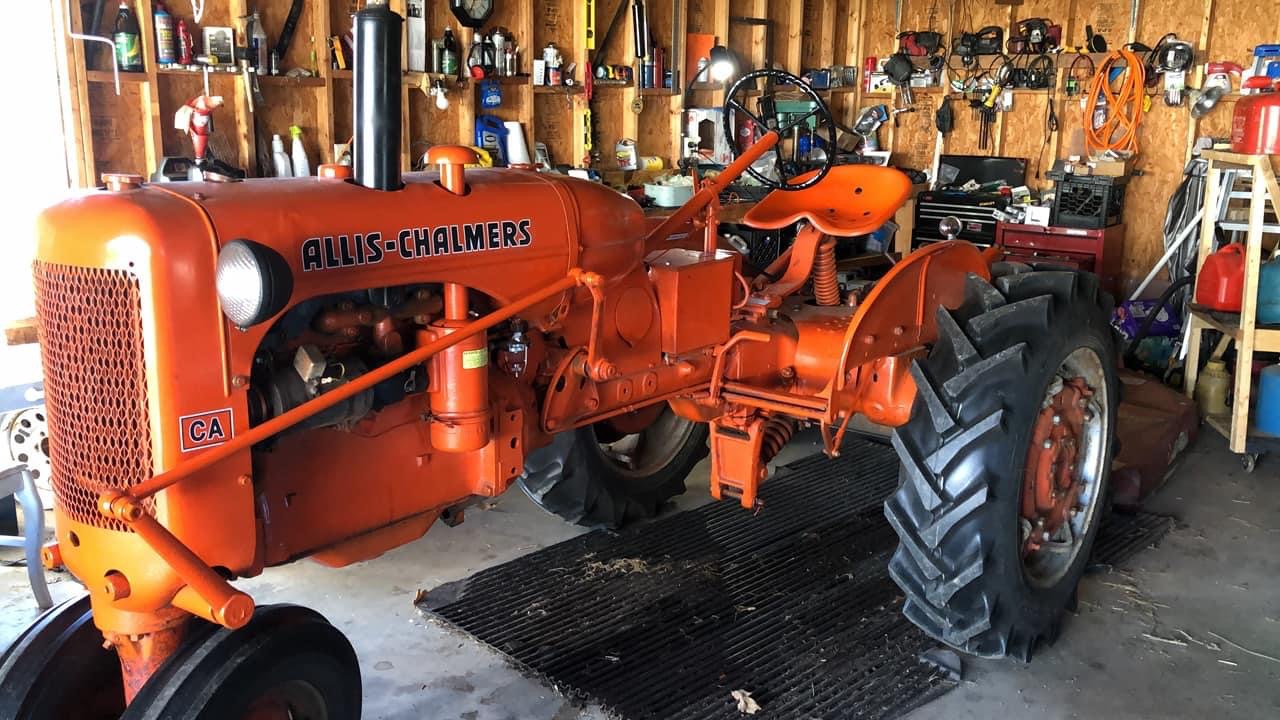

Hello everyone.
I've been working on a restore in between using my CA for actual field work. I was getting ready to take it out today to brush hog and when I put the PTO engagement shaft in the active position the engine bogs down, and the gearing in the PTO make alot of noise -  clanking tick almost. When i try to disengage the PTO the shaft is locked and the PTO seems to be locked also. i had to put it in reverse to get tension off the gears and lower the arms. Was planning on pulling PTO this winter anyway to replace the leaky gasket but not sure where to start with this new issue. It had been working no problem beforehand.
