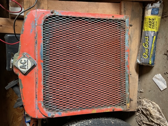

Afternoon All,
My dad just recently purchased a well rig with the Allis Chalmers G226 Power Unit as the power source.
We are trying to get the rig up and functional and need a replacement radiator.  The Engine block # is 17-74960-V.  From my research online, it does not look like the D17 Radiators are a direct fit to this unit from what I can find.
Is there a viable solution for a replacement?
Any information leading me in the correct direction would be greatly appreciated.
Thank you for your Help
Bill

Post Options Post Options   Thanks (0) Thanks(0)   Quote steve(ill) Quote  Post ReplyReply Direct Link To This Post Posted: 29 Sep 2023 at 9:53pm
does it look like a WD45 radiator ?  ( tractor prior to D17)

Post Options Post Options   Thanks (0) Thanks(0)   Quote DFCI Quote  Post ReplyReply Direct Link To This Post Posted: 02 Oct 2023 at 10:52am
Steve(Ill),
The top of the radiator I have looks like the one you have pictured.  Where the radiator hoses connect are different though.  But it does look like the engine cover would fit properly over the radiator.
It could be the correct one.  I think this unit has been Frankensteined.  I found out the installed carburetor wasn't the correct one either.
