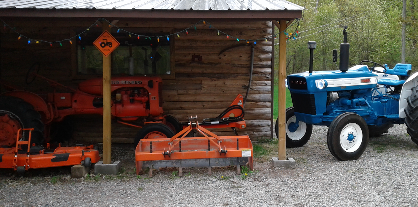

I gotta get the poor old girl looking as good as the Ford.
