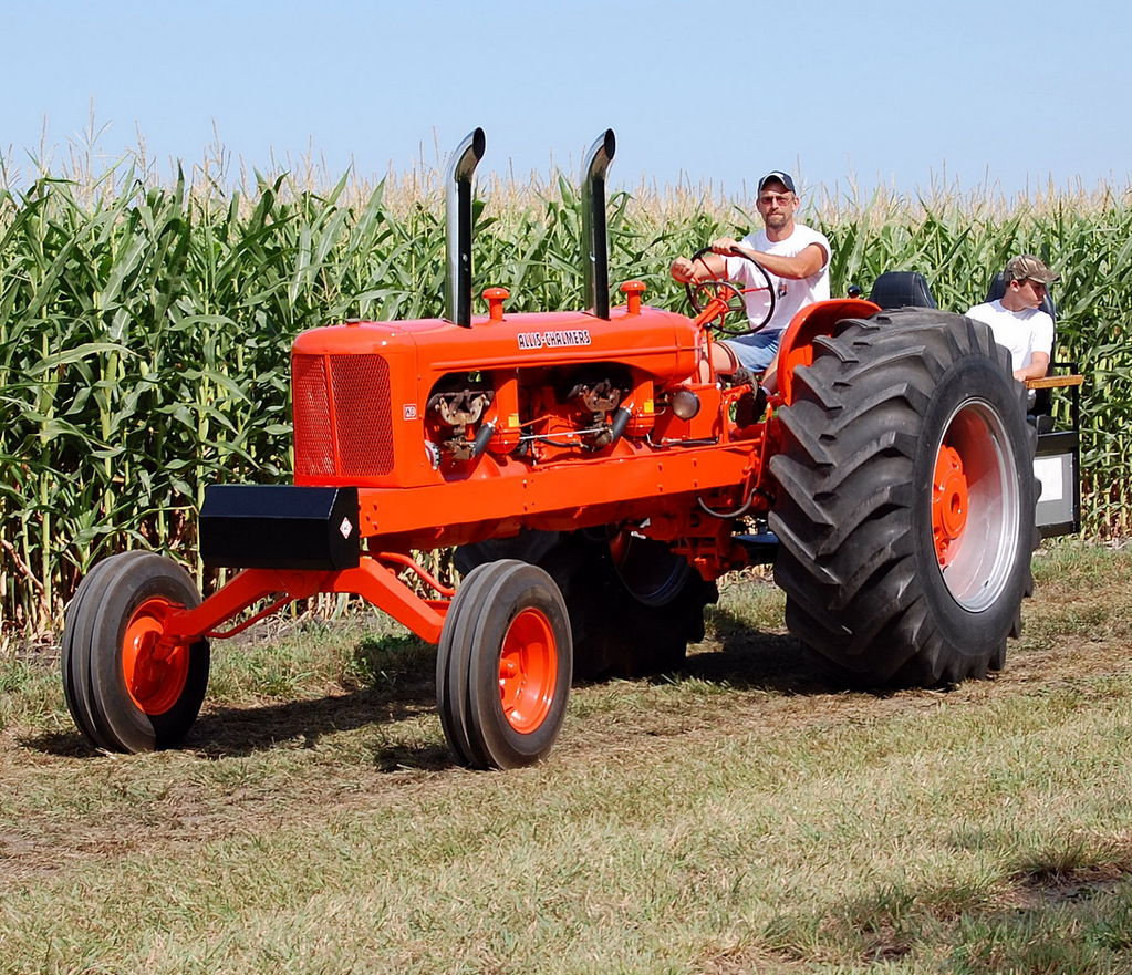

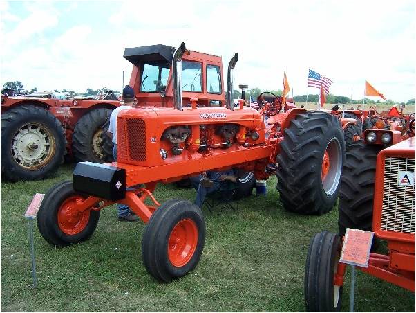

Not a WC, but one of the cleanest installations I've seen. This tractor could drive up behind you and you could barely hear it. It was whisper quiet. Also note the hydraulic pump on the pulley location.
This was at Hutch a couple of times, and at Almelund this past summer. We talked to the owner, and he uses the tractor regularly, and drives it to shows within 20-30 miles. It's a very nice tractor.
are genuine." - Mark Twain

 Innovative way to handle steering !

Thanks for sharing that GB. It is a super clean install. Lot of time and effort. Very well done. Governor? What would you get a governor from? I would imagine they would have some sort of industrial application that one could get a working governor from.
Also, I noticed the exhaust manifolds seem to be flipped over. I was wondering if that would work. I want to put an Inline 6 in the parts C that I have. I know where there is an old derrick hoist engine that would have governors.

I have always thought this one was a great conversion. He did a very nice job.
