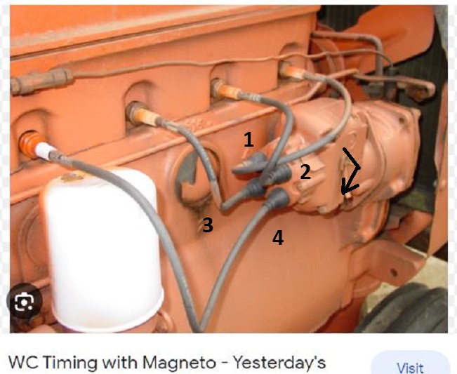

UPDATE for the '37 WC: After further analysis, I found a crack in the top half of the casting that causes leaks. I took upon it to order a refurbished carburetor and once it came today I put it on and after several tries to pull start the tractor it did turn over and run adequately enough I could drive with it. However it still has several issues. It sounds as though it's running on only 2 cylinders. I checked and all four plugs have a spark. Any thoughts?

timing 1-2-4-3..... front is #1  ?

got the order right....do you have the rotation right?

The first thing I would do is to try to figure out which cylinders are firing. Grounding the plugs out should let you know which cylinders are dead.
A few potential problems come to mind.
Champion spark plugs? They are junk right out of the box.
You say "original wires". Are you sure they are solid wire?
Do you have consistent, steady fuel flow?  MANY of these old tractors have fuel issues.
Do you have any moisture inside the magneto cap? This is one of the very few places I find WD-40 useful.
As was said earlier, check your mag rotation. #2 and #3 can be easily switched.
