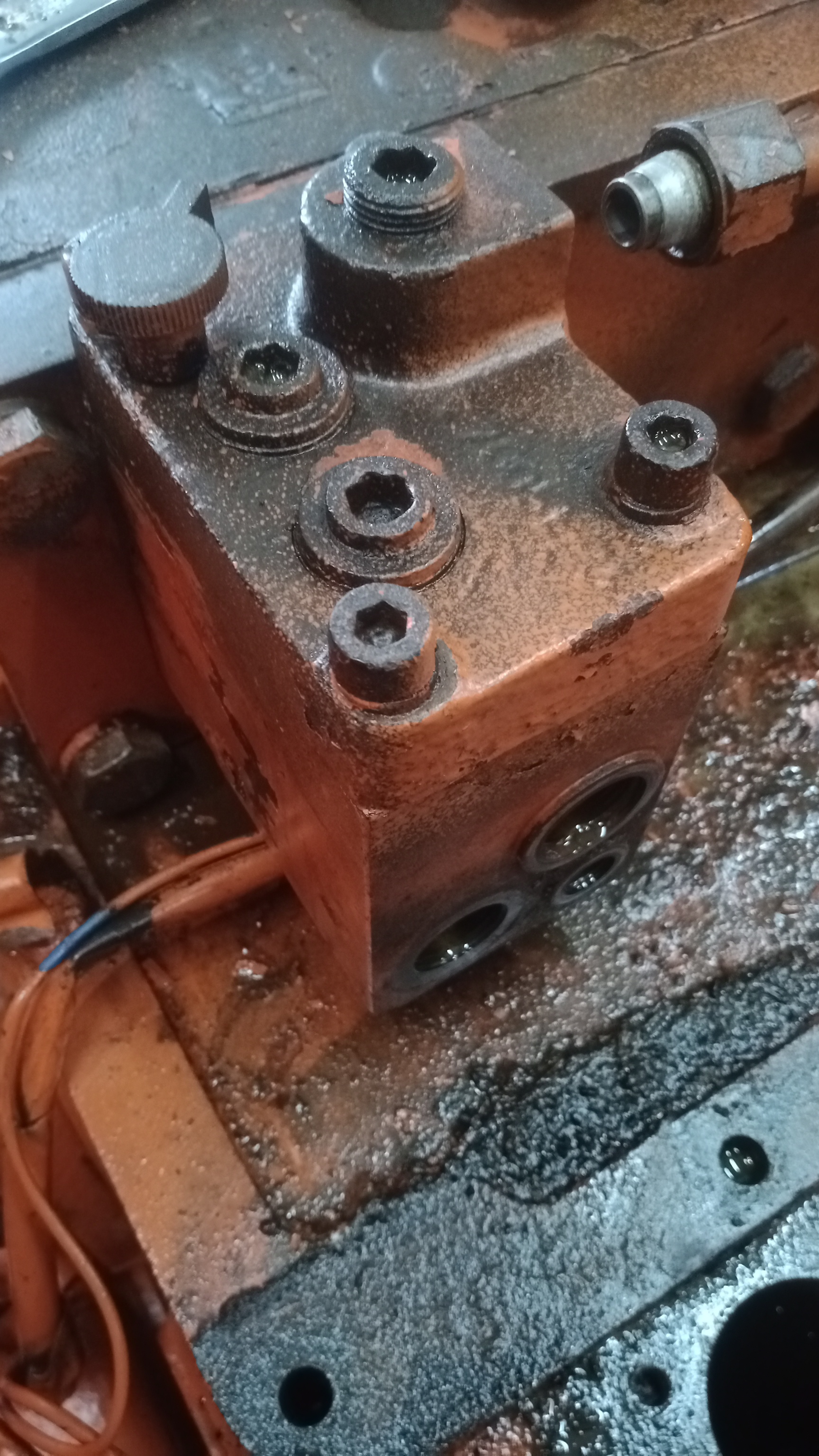

Thats the lift arm control valve. My hunch is the lowering spool is stuck

So after more investigation I think the flow control valve is stuck. I removed the big plug from the front of the control valve and the spacer that was behind it but if I'm reading the diagram correctly  there is a spool in there with a spring behind it but I can't get it out. Thoughts?

So I finally got the valve off. Playing with the height of the lift arms and the control levera I was able to get the play to move forward about 3/4" .
At that point I was able to pull the pin that holds the linkage to the back of the plate.
I disassembled the valve definitely had a stick spool the one under the largest plug. Put everything back together and now back to the beginning it won't go down.

Success!!! I think don't want to fire it up tonight. But I was able to pull sensing spool out from the front.
If your hitch is stuck up chain it up so it can't fall by itself other wise as soon as you start pulling it apart it'll push all the oil out when you pull the top off.
Here's what I did.
 I removed the knob and the plug/threaded bushing along with the springs that are in there. Also pulled the top off otherwise the lowering spool (the one on the top towards the front) could keep it from coming out.
I tapped the spool in and it was hesitant to move but went a 1/16" then I attempted to get it to come out.
The trick I used to get the spool out was to use a 5/16 bolt about 3" long with some vice grips biting on at 90*.  While pulling on the vice grips it would bind the bolt up in the center of the spool then a small prybar to lever it out. As soon as I got a 1/16" I tapped it back in and tried again.  Finally got spool out a light touch with some 1200grit sand paper flush it all out from the top with some oil. Then slid it back in and out a few times to make sure its sliding smoothly.
I put it back together removed my temporary chain pushed the position control forward and IT LOWERED all by itself. and stopped when I brought It back up. So I think its good. I'll give it whirl in the a.m.
