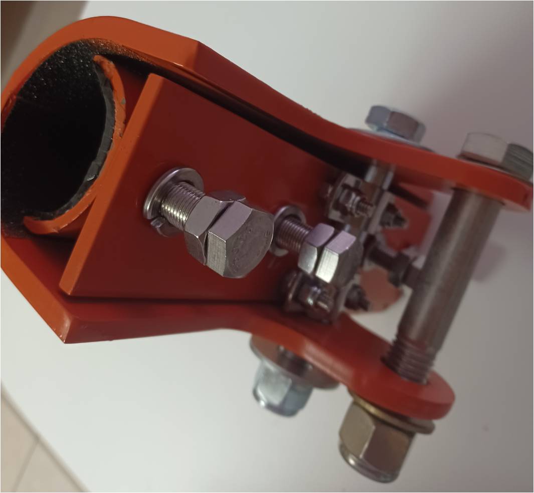

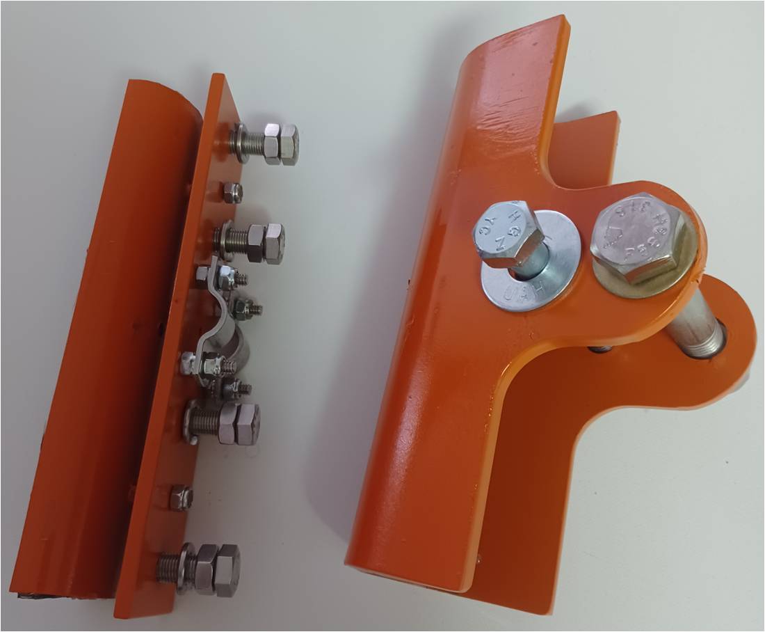

I was really happy with the "new design" CA top link bracket design, but there are a few issues that I wanted to address.  For one, it seems to be designed for a larger diameter rockshaft than the CA rockshaft so there would be quite a lot of movement slop.  So, I've developed a clamping mechanism that should work reasonably well.  I don't think I can generate enough clamping force to absolutely prevent rotation under load, but at least it won't just flop around.  It consists of a flat plate that pushes against the inner bolt of the bracket and in front of that is a loosely coupled half round clamp section.  Clamping force is applied with 4 fine threaded half inch bolts with lock nuts/washers.  Because the new bracket design is very wide, the clamping force should be reasonably good.  I didn't have a nice butyl insert so I made one out of an inner tube.  It didn't want to comply/conform very well.  The second issue is that I want the top link bolt/pin pattern to be horizontal.  I'm still waiting for parts to finish that bracket adaptor design.

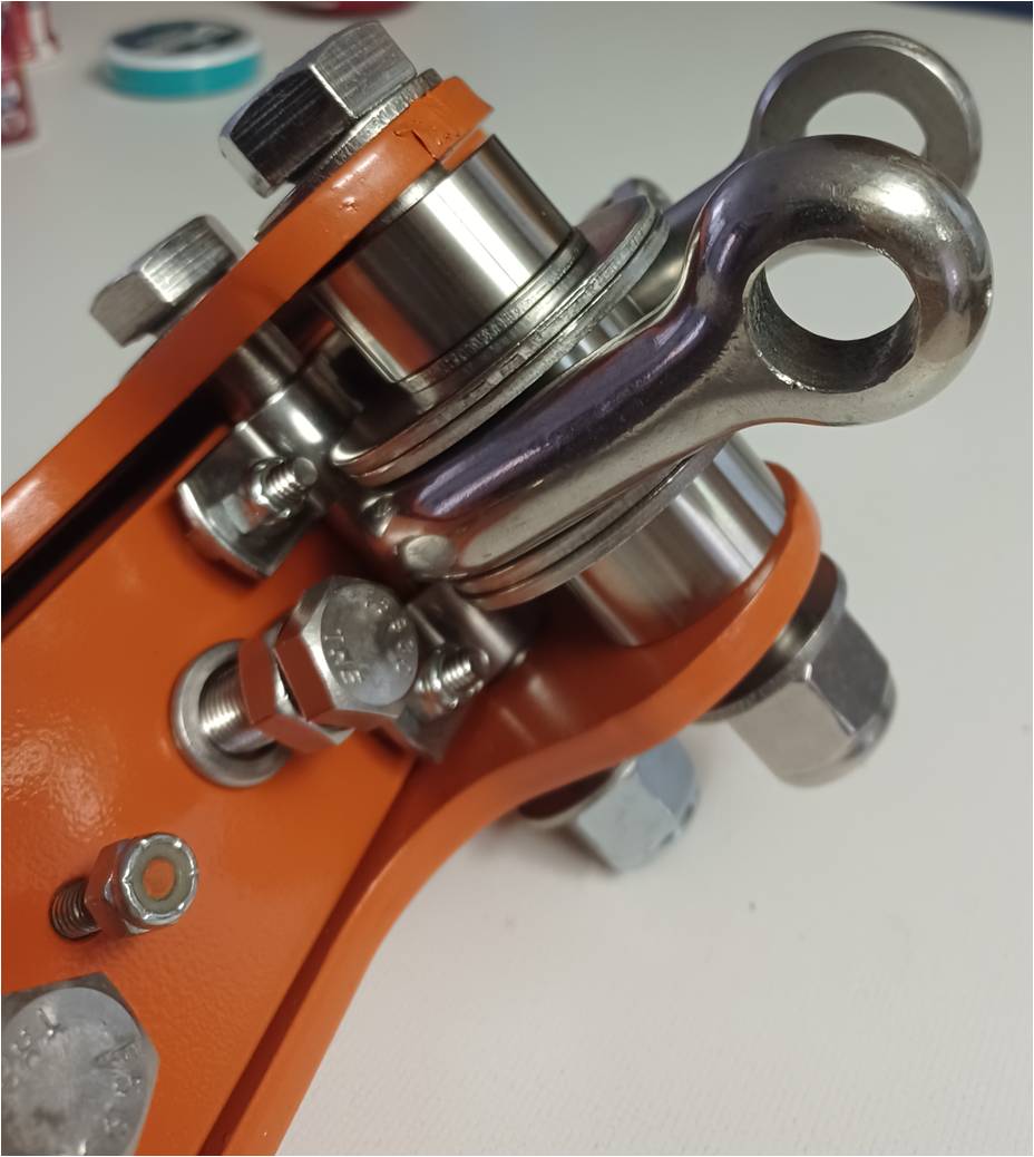

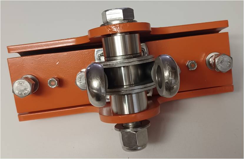

Here is the adaptor modification for attaching the top link horizontally instead of vertically (which aligns with the natural orientation and range of motion of the top link itself).  Basically it's a D shackle with spacers to adjust its position and range of motion.  We'll see how it works :).  I really dislike machining stainless steel, but mods were necessary to the D shackle :(

What problems did you have with the bracket rotating on the rock shaft ??

The CA rockshaft is only 1 and 7/8ths diameter.  This bracket is designed for a 2.5 inch rockshaft.  There's no possibility of tightening.  You'd have to nearly pinch the two halves of the outer tab together to have any hope of clamping to the rockshaft.  The bracket is thick alloy steel.  I think you'd come close to stripping the 5/8 bolt if you tried to clamp down that much while in the process deforming the bracket to the point that the top link wouldn't attach.  So, there's no doubt there would be quite a bit of side to side motion slop in addition to it being 100% free to rotate.  That may or may not be a problem in some real connections, but I just didn't like it.

Very nice work. I designed the bracket you started with and it was actually made for the wd and wd45. So the CA does have more slop. The manufacturer was willing to make what you have but not any other improvements. Having sold them for 20+ years the only problems we ran into were an auger that had to have a horizontal pin and some that did plowing and pushed on the bracket in use. Any lifting pulled the bracket and the slop didn't cause any problems. It's been a battle to keep the prices down and your work is terrific, but would be very expensive for our customers.
