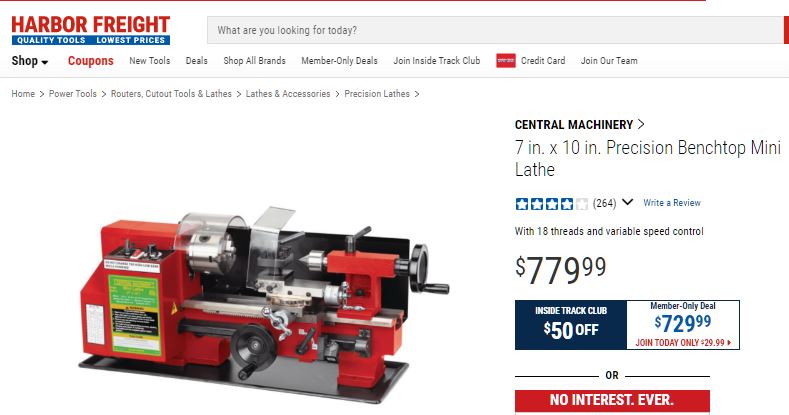

Rick, you normally dont MOVE a lathe on and off a table... The SMALLEST lathe you might use that could be moved would be a 7 inch China unit like this...
couple problems... One is HOW are you going to mount the brake shoe ?  These small lathes have a 3 or 4 inch chuck... so what can you GRAB to turn the shoe ?
Second problem is with a 6 inch shoe in a 7 inch lathe there is no room for the CARRIAGE / TABLE to run under the shoe... It would have to stay to the right and you would use a cutting tool to extend to the shoe face.
If yoy want the carriage to travel UNDER the shoe, then you need a 7 inch swing OVER the carriage, which would make the lathe about 10 inch.... and thats too big to carry around.

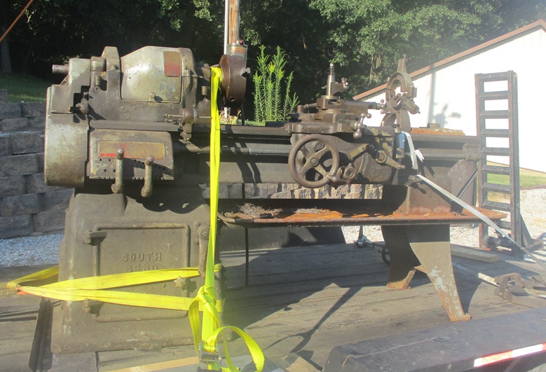

My little lathe swings 13" x 40"... but putting it on a benchtop isn't gonna happen...
The Monarch 10EE weighs about 3300lbs...
If you can lift it by hand... it won't be cutting much, but...
