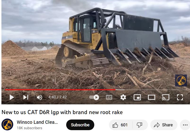

Points: 87234
Post Options Post Options   Thanks (0) Thanks(0)   Quote steve(ill) Quote  Post ReplyReply Direct Link To This Post Posted: 22 Jun 2023 at 1:47pm
since you have a Dozer, you might have more luck attaching a root rake to the blade instead of dragging something behind you....... then DISC afterwards.
