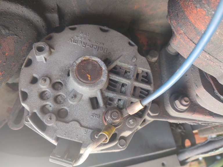

Here is the picture of what I have, in case someone can shed some light.  What is the purpose of the jumper wire?

A alternator will not charge without battery lead hooked up. Check voltage at big post on alt. With tractor shut off. Crank tractor with some RPMs and check same place. Should have around two more volts unless battery is full charge.                MACK
Points: 93401
Post Options Post Options   Thanks (0) Thanks(0)   Quote steve(ill) Quote  Post ReplyReply Direct Link To This Post Posted: 17 May 2023 at 10:09pm
That white wire going to the double spade connector is an ODD BALL... If it was a 3 wire and using the two spades, you need a signal wire to #1 and a jumper from BAT to #2 .... If it is a 1 wire alternator, you should not need the jumper to the spades... So yes, something is wrong.......... you can go either way, 1 wire or 3 wire .. your choice.  and YES that is a DELCO 10 SI.

On the back side of the black plastic connector there appears to be a connector but no wire attached.  I think it was there at one time.  Is it possible that a second wire was attached?  I can't see where a 3rd wire was ever attached.  Can an alternator be useful as a 2 wire?  I am going to look around and see if I can find a wire under the dash not attached to anything.  By any chance would that missing wire go to the the dash voltmeter?  It so happens I have a non Allis voltmeter gauge  in the dash.  It seems to be working too because once I turn on the key I see the voltmeter gauge go to 12 volts.
I don't think I need 3 wire since it is merely lights only on the 190XT.
I also tested the output with a voltmeter with the blue wire attached and it definitely is not putting out 13-14 volts.
The blue wire goes to the voltage regulator and not directly to the battery. That blue wire is always live.

Blue wire goes to the amp meter ( your Regulator is internal ) in your photo i thought the WHITE wire was attached to the PLUG.. But that does not make any sense.. If the PLUG is just covering the two spade terminals, then you have a standard ONE WIRE alternator..  A 3 wire alternator would be wired DIFFERENT inside and the two terminals would be  #2 HOT and #1 SIGNAL from the dash light.. Someone could have removed the  NOT USED wire... In the beginning ( 1970s) it was not a 1 wire system.

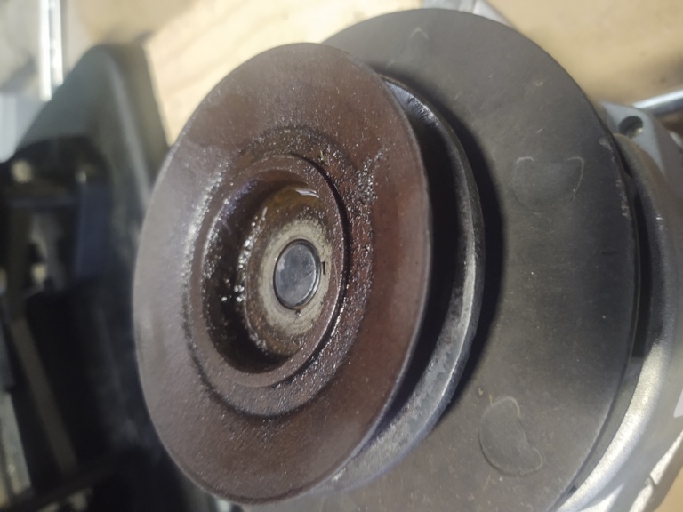

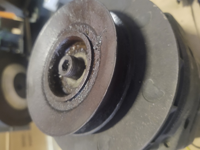

Like always, things aren't straight forward for me as they should be.  I bought the 10Si and it is not exactly like my alternator.  I pulled off the pulley so that the same belt could be used and there aren't enough threads on it to put the nut on.  Here is the new alternator with old pulley.
Here is what it looks like on old alternator with old pulley.
If I tried to use the new alternator with the new pulley, the belt would be out of alignment since the shaft is shorter than the other one.

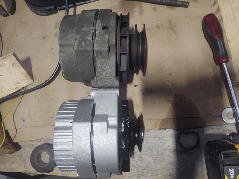

This picture shows the difference.  it is about 1/2 inch shorter.
 So, I guess I am going to have to get the old one rebuilt?  I don't want to keep buying other alternators without knowing the shaft length, only to have the same problem.

If he wanted to modify the mounting bolts with a few shims, the 10SI that he bought would work fine.

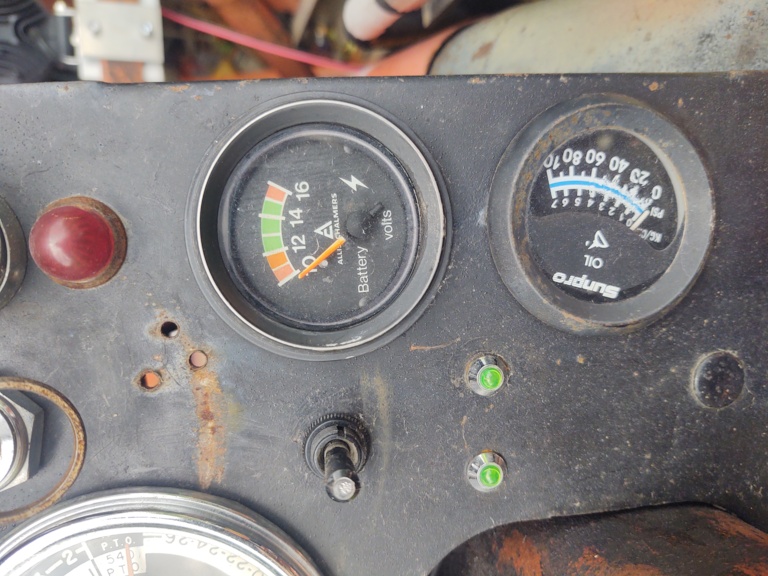

Here is the voltage gauge that I have and it works although the alternator wire is not properly attached.   Is this gauge a 190Xt gauge or from something else?  Seems I didn't see this in the parts book.  It says Allis Chalmers on it.   That non-standard switch and led lights in the middle is a turn signal switch and signal indicators that I installed in case you are wondering.
 The oil gauge is connected to nothing so I think it was going to be a future improvement that never got done.

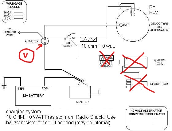

Since I have a diesel, I don't have the ignition coil, distributor or ballast resistor to worry about.  It seems that I don't need the external voltage regulator installed below my dash.  Can I remove it?  I also don't have an ammeter but rather a voltmeter in my dash and I assume I can use it rather than an Ammeter?  Here is a 10W/10Ohm resistor that I am going to use.
I am not sure about sending the wire to the headlight switch from the Voltmeter?  Is that what I want to do?  I haven't tracked my ignition key wires yet but do I need to do anything different there?
So, here is what I think I need to do to wire for a 3 wire alternator setup once I get my alternator fixed.  Thanks for the help.
Points: 93401
Post Options Post Options   Thanks (0) Thanks(0)   Quote steve(ill) Quote  Post ReplyReply Direct Link To This Post Posted: 22 May 2023 at 4:11pm
YEP... and a VOLT METER jus measures voltage OUT of the switch to GROUND... not INLINE like an amp meter ............. maybe something like this....and you can put your head light switch wire on one of the ignition switch wires.. if you put it on the LEFT side, you can have the head lights on with the ignition switch off... if you put it on the RIGHT side, then the ignitions switch kills the power to the head lights switch.

Sorry I disappeared on this thread. I've been busy working on our deck out back on the house along with other projects around the house and property taking advantage of the nice weather. The 10SI and the 12SI have the same .670 mainshaft so the pulleys are interchangable.  Depending on the pulley, some Alternators may have a small spacer behind the pulley that would need to be removed to install the OEM pulley. That in most cases will give you your alignment. Steve's Voltmeter diagram is okay, but the #2 circuit on the Alternator is not jumped to the output stud. A true three wire setup would be the #2 (voltage sense circuit) run parallel with the heavy output wire and join together at the Battery side of the Starter Solenoid. The voltage sense circuit can then monitor current usage at the Solenoid for the Battery as well as at the dash where a lot of current is being used. Any accessory that is turned on, the voltage sense circuit will then sense the load in the system and ramp up the Alternator (if necessary) to counter the load usage.  This keeps the Battery "full" as well as monitoring the system . That's how a true 3 wire system operates. The charging system upgrade kit that I mentioned is our 1503-02A kit.  HTH
Steve@B&B

Steve in NJ.  No problem on disappearing .  It is free advice.  Thanks for this info.  I have purchased the 12SI so the kit isn't appropriate for me now, but I might be in need of the proper wiring kit.  i will digest what you said.  I can't stop using the tractor long enough to fix it right now.  So, I put a battery charger on it every night.  I still think I have a pulley alignment issue but i will see once I dig into it.
I believe I purchased a 3 wire only 12 SI but no one at NAPA could really figure it out so I need to be ready to get it all working and not just swap out the alternator.
