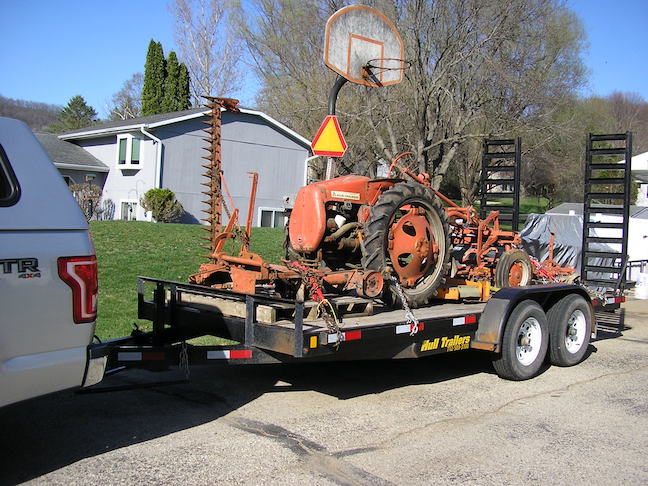

This is what the trip to Illinois was all about. This tractor has sat since the 90's. I bought it for some of the implements that came with it. I did get the tractor running and it runs well but I have no oil pressure showing on the gauge. I doubt the gauge does work. I have read some previous posts about G's losing prime etc. Is the relief valve plug right below where the gauge mounts? On a side note I will have a 2 sets of cultivators (1 of each style) for sale in the near future. Also a #4 sickle mower.

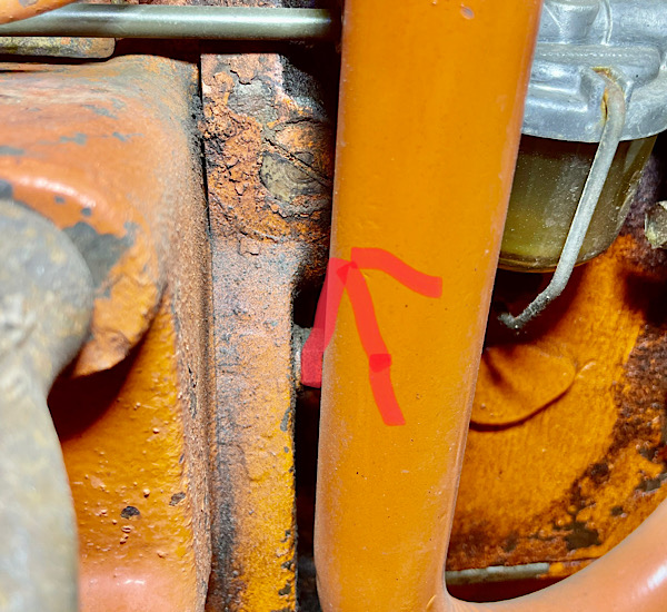

 Mike, id swap a gauge out before I got too carried away, while it’s out I would pour some oil in the hole to help in case It has really lost prime. Relief vale is just below the gauge, kinda behind the air tube

Thanks Joe. I wasn't looking for a screwdriver slot. Found it.
