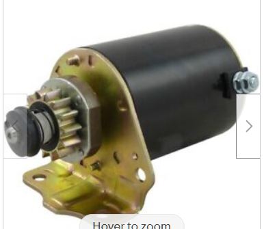

We have a trusty Agco Allis mower with the 16 horse Vanguard. A issue that started last year is still prevalent. Not always but sometimes you turn the key to start it and the starter spins but dosen't engage the flywheel. I have gone as far as tapping the starter with a rubber hammer thinking it would engage but nothing. I finally had to disconnect the battery to stop it!! Just need a new starter or any ideas? Thanks in advance, Ryan

the gear on the end of the starter is spring loaded and setting on a CORK SCREW shaft.. When you  spin the starter, the gear flys OUTWARD toward the ring gear , screwing itself out on the CORK SCREW by centrifugal force.... Just pull the starter off and soak the end of the gear/ shaft with WD 40 or some thin oil and work it back and forth.. If the spring is OK, i might just need a good cleaning..
Edited by steve(ill) - 06 Apr 2023 at 9:35pm
Points: 88268
Post Options Post Options   Thanks (0) Thanks(0)   Quote steve(ill) Quote  Post ReplyReply Direct Link To This Post Posted: 06 Apr 2023 at 9:34pm
move the gear with your finger to see that it is FREE and slides EASY.

Try to look at the white plastic thing under the spring, with the spiral grooves for a "burr as well.  if so take a knife and with care, cut it out.
