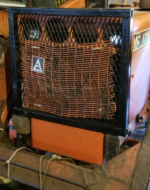

Shop made but this works well for me. Previous owner had run over the grill with a bush hog. What's left of the old screen in the middle. 1.5 inch heavy wall tubing and expanded metal. Made two sockets that it slides in. Very easy to lift out and clean the radiator, heavy enough that it protects hood, lights and radiator when I bush hog autumn olive.
