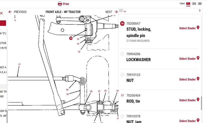

I am rebuilding the front axle on a WF. My local machine shop made me the new front pivot pin and king pins. There is a tapered part that goes through the king pins (to hold them in place) Both of mine are damaged (probably useable if I can't find any). I would like to find a pair, if possible. Does anyone have a pair they would sell or even a part number?

This one?

Yes, it is the # 16.
Does anyone have a pair of #70200047 they would sell?
Thanks Jim !!!

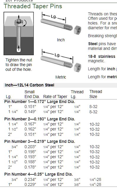

Most taper lock pins are made to a specific size... Most are 1/4 inch per foot taper.. If you know the length and the diameter of ONE END, then you can buy them on line.. Kind of like BOLTS... you dont make them, you BUY a standard size..
This is from McMaster Carr...... there are dozens of different sizes.

The Mcmaster taper pins shown use the nut to pull them.  They are commonly used to hold position of bearing housings and adjustable parts after alignment on machines like paper machines.  It might be what was used, but I wouldn't expect a pin that tightening the nut would loosen it from the axle, to be used to hold a kingpin.
Truck and other steering axles I am familiar with have flats or key type ridges on the lock pins/studs that mate with slots in the side of the kingpins.  The lock pins/studs may have threads with nuts that pull them in tight or may just drive in tight.  I would expect such to be holding the WF kingpins.

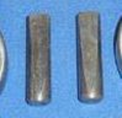

The "taper pins" go through the housing and through the slot on the king pins (2 bottom pins of picture below) to hold them on place. The taper pins have a flat side that fits against the flat machined area of the king pins.
My neighbor that has a machine shop made these pins for me. The top is the front end pivot pin, that had no grease fitting (it does now!). The bottom are the new king pins. I think he did a great job!
I am going back out to the shop later tonight. I will take a picture of the taper pins and post them.

Here's a picture of one of the taper pins.
