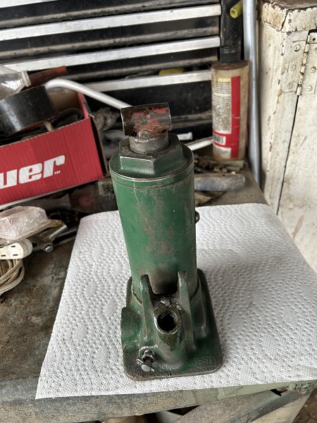

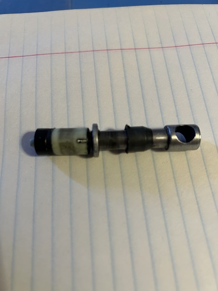

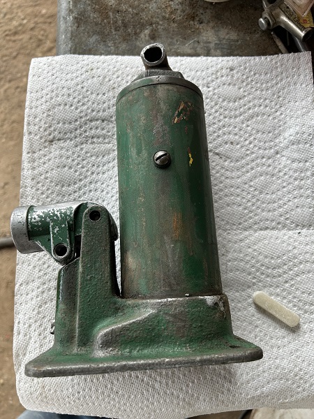

  Well, finally got around to getting the Extra Hvy Duty engine puller operational and even tho I knew the hydraulic bottle jack was questionable,,,IT don't jack up or down,,,,,WinkWink
 It has like a two piece piston of several small pieces instead of the usual and customary straight piston with the seal at end of piston. I got some pics so maybe someone can ID that jack or know where to call to buy a kit. There is NO name on jack. There is some numbers on base right by the pump mechanism ,,,2-73. Also 511-7 on big nut on cylinder. On bottom of base is 1121-1001

Looks like a Hein Werner.
I have 12-ton HW bottle jack that has that jointed piston.  I have looked for one and have about given up as the one I found so far, they wanted more for than I could buy a couple new off brand 12-ton jacks for.  Total for rebuild parts cost was looking like better than 3X the price of a new jack.  I would like to fix it, but it is one of those where you have to ask, is it worth it.  For now, I have 2 new 12-ton jacks to use. You might want to look at modifying a new jack to take its place.

   Yeah Tom and Jim,,thats kinda what I figured,,,I musta looked at several Million images of  bottle jacks and not find one that might come close to having the similar dual piston insides ,,,and after asking myself "If" it was such good idea,,,,why didn't it get copied???  My guess is this antique will find it's way to the junk pile and Joe will find his way to Harbor Freight.,,, Many THANKS for ya'lls efforts ClapClap

Here is the jointed piston I found.  Plus, another $60.00 for the rest of the kit and shipping.  The Hein-Werner is a god jack and I like it but there is a limit.  So, the Harbor Freight jacks win, a product of our throw-away society.

 Yeah Jim,,that sure looks like the piece I was looking for but like you say,,,$99.68 is too steep plus the rest of kit plus S&P,  is definitely too much when  you could buy 2 or maybe 3 new Jacks at HF for same money,,,,ole Shameless may call me Cheep all the time but I like to refer myself as Frugal,,, THanks for that link!

would it be possible to make a straight piston ( on the lathe) and put a couple o-rings on it for seals.... then modify to top pin attachment to be more of a WOBBLE STICK, like most other jacks ??
I certainly won't say it couldn't be done.  I will say HW made a different 12-ton model that looks the similar that uses a straight solid pump piston.  However, I can't find any info they can be interchanged, and I am too "fugal" as Joe says to buy one just to find out they won't interchange.  I figure my risk of failure is less with the new HF jack.

 Hey Jim and Steve,,seeing as how very much I like to play with my lathe,,I may just try  to machine a one piece piston for the HW when I get bored with my other projects (I've always thought "Variety is the Spice of life",,,,LOLLOL
