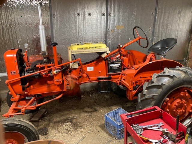

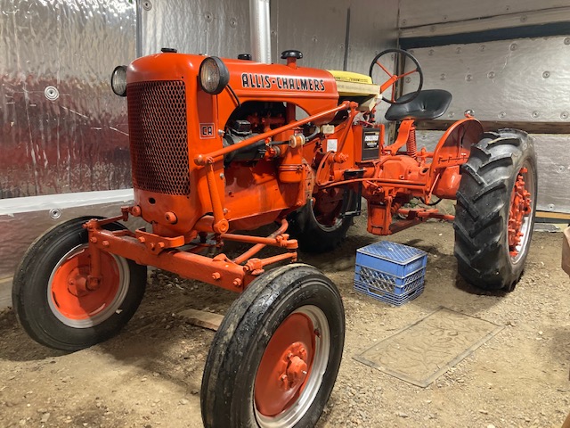

Since I bought this online never hearing it run I was anxious to hear what I have. Changed all oils filters HD coolant, plugs points condenser cap rotor wiring hoses belts, new temp gauge batt cables rebuilt carb etc. The dang gas tank remains to be fixed. Today I installed a champion gas tank from an old generator we had in the scrap metal pile. Wood, glue, screws, bolts and rubber padding installation. New gas lines, fittings and filter. She popped off quickly with her new ought battery cables and ran ok. I timed it by ear (for today) and took a ride in 25* 4pm conditions. Brakes, clutch, hand clutch, gear all seem perfect. Steering is as new no slop at all. Third gear perfect. All gears checked going downhill. The more it ran the better it ran. The old man collector Had really taken care of it and I don’t believe had hardly used it. That’s all for this evening news 😁 folks! Stay warm, safe, happy and healthy please! Dana
