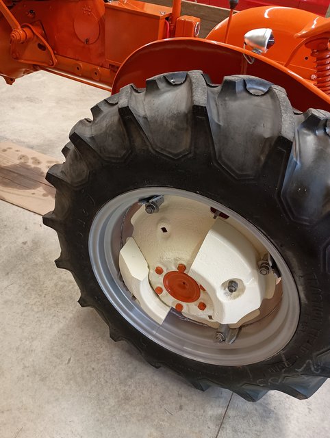

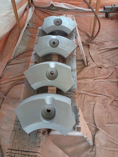

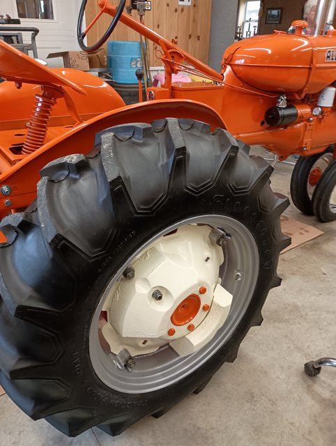

I got the wheel weights on the rear. Thinking of getting the other set of rear IH weights cut in half too? Would be much easier to handle for sure! I need to see if my machine shop has an easy way to cut these IH weights. Would need another 500 lb. The engine weights plus the 2 more IH rear weights and a bunch of my 15 lb weights would be needed.
Still have the engine weights to wire brush prime and paint PO#1.

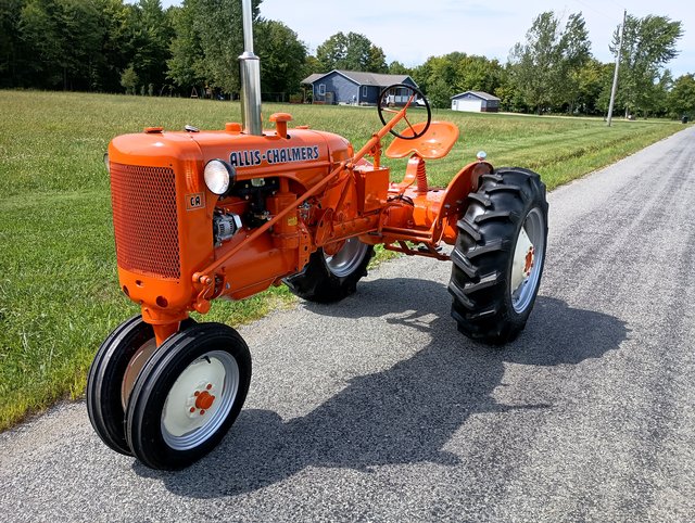

Thanks for the support on this CA project. I took it for a 1/2 mile ride. Yep steering is stiff but manageable. Short arm, long arm is not the best combo. Valve cover gasket seems to be finally sealed up.
On the adhesive. I used trim adhesive to hold the material between the hood and gas tank. Worked well to not have that flopping around. Putting the sprung out hood on is really a two person job.
Added some sealer to the coolant to slow down the leaking hose out of water pump. Some improvement to that leak.
I removed the Zenith carb again and adjusted the float pontoons lower, hopefully shutting off fuel flow sooner. (A lot of Allis tractors must have the fuel shut off do to carb leaking).
I have not tested the float adjustment, but I am sure I will forget to shut off the gas at some point.
The CA starts very well. No choke or throttle required. Sounds good a all throttle positions. The replaced cam doesn't seem to have any negative changes to the sound/or performance of the engine.
I did get the rear wheel weights cleaned up and painted the light cream color of the rims. Those four split IH weights should put the CA at about 2500 with me in the seat.

...It steers very firmly! No wobble in high gear on the road. Will work fine as a puller!...
I was curious as to how that long arm/short arm combination would work

Next is to clean up and paint the weights needed to get to 2500 lbs. Maybe even the 3000 lb class.

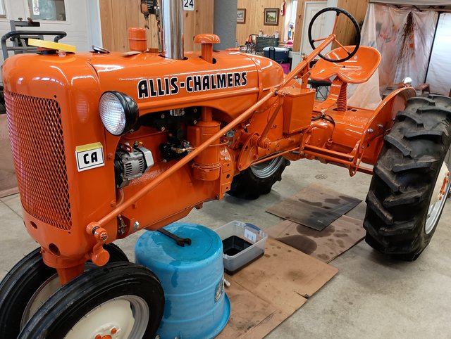

 I welded in a sheet metal patch where the hand clutch was. I thought someone might get a small foot in there.
I added some gas and friend John came over this morning turned on the gas, flipped the key and pulled the starter rod. It fired up. We weren't there. Got out to the shop in a half hour and started it several times today. Even took it out around the shop. All gears seemed to work. Brakes worked very well! Steering not great, stiff. Should work fine for pulling. Oil pressure was very good.
Had a minor problem with the side hood bolts being too long. My fault. fan blades hit them and luckily did not do much damage. Got that fixed (Dodged a bullet on that fan thing, could have been way worse!). It seems to run pretty well.
Have some oil coming out of the short hose from the air cleaner to the carb? Not sure what the cause is? Also have a leak at the upper edge of the hose from the water pump to steel tube. Pictures are coming!
Tomorrow is Cheryl's birthday! Hoping to get the decals on tomorrow too.
Warmed it up at different rpm's, pulled valve cover and set valves to .012 inch.
I repainted the hood strap and the oil filler cap this afternoon and installed them this evening. The paint was too light, ok its not going to be perfect. Went around and touched up a bunch of areas that have been light and or missed or scuffed.

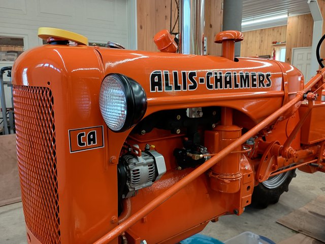

Tonight I completed the spark plug wires. Primed the oil pump. Got a new battery from Walmart. The old battery had been used on my electrolysis tank and it is pretty hard on them. It would spin the tractor and then die. Took a couple tests to determine it was not good under load. Oil pressure is at the N in normal with our running yet. Just cranking.
I tried the hood. Looks like it will be ok when finally fit.

I know the cable colors are not correct. But that is what NAPA had.
Luan cover to keep lid off the terminals
The silver bullet
Cheryl helping prime the oil pump. Crude set up but it worked!

The Carb came up on the list of things to do. It was very dirty and crusty inside and out. Several of the brass jets had already been messed up. I did not have new ones in the kit. So these were cleaned with carb cleaner and opened for fuel or air flow. Emulsion tube was removed and cleaned on this Zenith carb.
After some cleaning and yes I blasted the top and bottom of the carb. They were that bad. I mask areas during blasting.  I had to rebuild the choke plate with the little spring loaded button. The button was froze up. I also put it together wrong. Couldn't figure out to get it back in for a couple tries.  Lots of little details. I need a better seal for the main fuel screw.
I know the carbs are not supposed to be black, and the fuel line is supposed to be behind the air cleaner.
Yep a black distributor:
I need to make up the new spark plug wires. Then begin to set up the wiring for the rest of the tractor.
We did prototype the front engine side weights. All looks good. Kolten said these should be orange. The rear wheel weights need to be the cream color. Not sure how much weight will be needed?
Thanks for checking on us.

We took the Comet to a cruise in tonight in Erie at the Bay front. We did work on the CA some today also. And did a test fit of the Great grandson Kolten in the seat. I think he liked it!
Kolten got a new bike also. They will set this up for local racing.
On the CA I realized I needed the extension on the sediment bowl.
Oil lines in place
