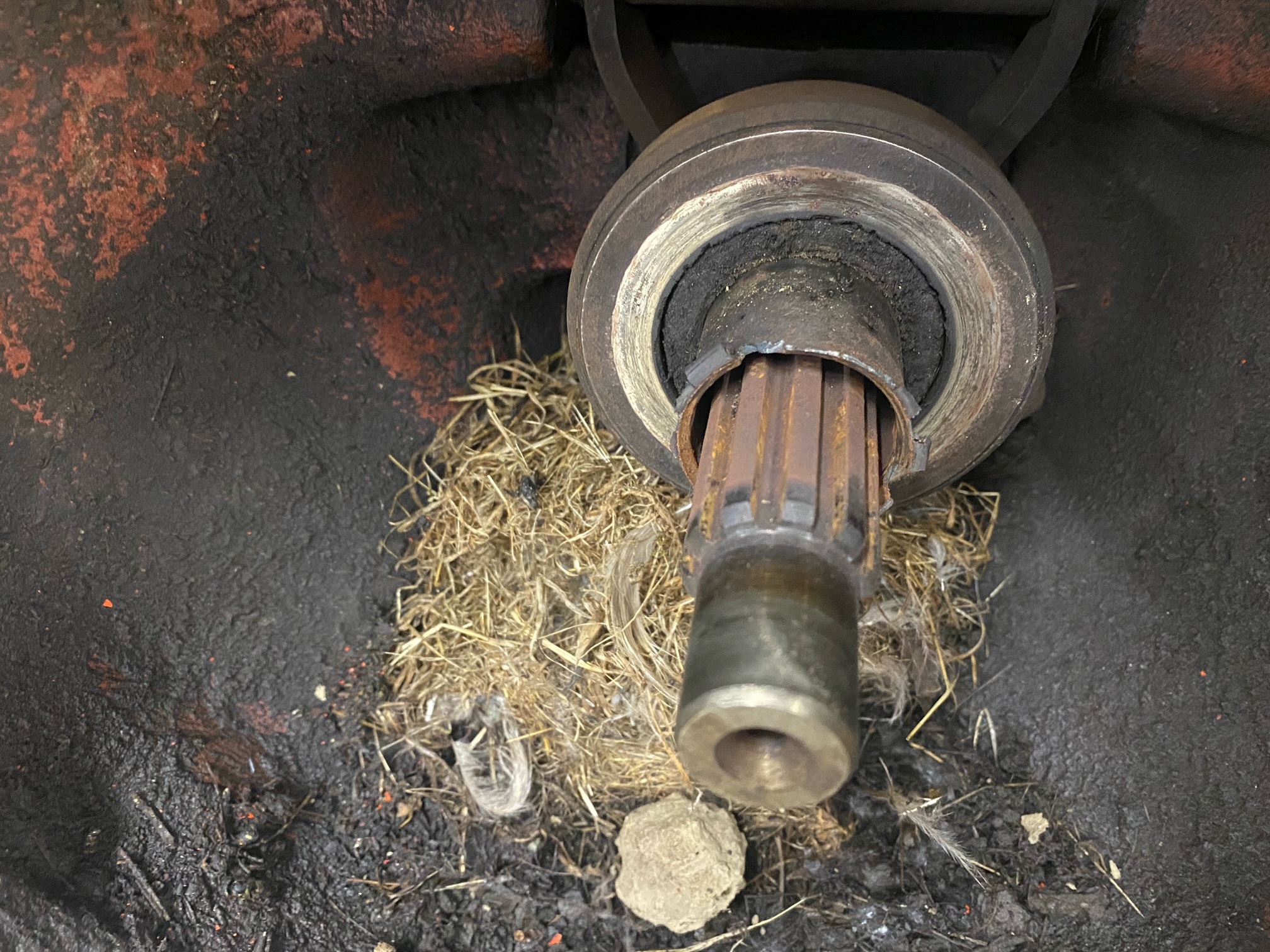

Hey folks, I acquired a 1961 series I D10 last week. I was told that the last time it was running ~5 years ago, the clutch was squealing, so it was parked. So the first thing I've done is order a clutch kit, and split the tractor. Well, it appears the issue is not with the clutch itself, but rather the sleeve that the input shaft goes through, and the throwout bearing carrier rides on. If you zoom in on the image below, you will see what I mean.
I don't have a parts manual for this tractor, so I don't know what this part is called, or if it is even available. Can any of you help me with this? If it is not a part that can be sourced from anywhere, what would be the best way of fixing it? And lastly, what could have caused the problem? Thanks for any assistance with this issue.

Is the throw-out bearing retainer free to move on that sleeve. If not, it appears that the throw-out bearing retainer has pulled sleeve from housing and grinding it against clutch disc hub when pedal was depressed.. JMHO, Tracy

Tracy, yes it does seem to move freely when the pedal is operated. However, it very well could have bound up at some point in the past and pushed the sleeve forward. I'll have to take it apart further to determine if the sleeve shows any indication of having moved, and if there are any signs of the throw out bearing carrier having bound up on it. I am assuming that the sleeve is not pinned in place, but rather a press fit into the bell housing. Thank you for pointing out that possibility, I will follow up soon as I am able to get back on the project.

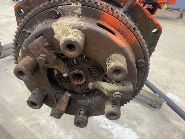

Post Options Post Options   Thanks (0) Thanks(0)   Quote seanb61 Quote  Post ReplyReply Direct Link To This Post Posted: 19 Sep 2022 at 9:01pm
Tracy, here is a picture of the pressure plate side of things.

It looks like the sleeve has rubbed the clutch hub. Fingers look really low on the pressure plate. I wonder if the clutch is correct in thickness and hub correct for D10-12.Can you show us clutch pedal rod where it goes to clutch fork, where it screws into nut.Has rod been lengthened? If the sleeve is correct for tractor and has not moved, this is probably your problem. HTH Tracy

Tracy, I will try and grab a picture of the rod tomorrow. I saw no indication of tools having been used on the bolt heads prior to me splitting the tractor, and the paint is original which leads me to assume that the clutch in there is the one that it left factory with. But I could be wrong on that. It is a very nice tractor overall for the age having been with one family its entire life prior to me. I included a picture below from when I first got it off my trailer and into the shop a week ago. I still need to pull the throwout bearing carrier and see if it moved the sleeve or not, there just wasn't enough time today for me to get around to it.

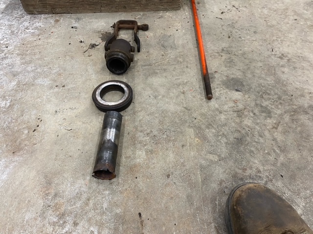

Post Options Post Options   Thanks (0) Thanks(0)   Quote seanb61 Quote  Post ReplyReply Direct Link To This Post Posted: 20 Sep 2022 at 7:42pm
Here's a picture of the parts now that they are out of the tractor. The sleeve came out without a fight. The rod that operates the fork was only threaded in about 1/4", just the very end of it, not much thread engagement.
I think the sleeve can stand to loose a bit of material and still function well enough since the throwout bearing carrier is long enough that it can overhang the end of the sleeve if it gets that far and still pull back inwards without binding. So I am going to try just cutting off the bad portion of the sleeve, and then dressing it with a file and sandpaper. See if that works before springing for a replacement. Will use permatex sleeve retainer when reinstalling so that it won't pull out of the housing.

Post Options Post Options   Thanks (0) Thanks(0)   Quote Tracy Martin TN Quote  Post ReplyReply Direct Link To This Post Posted: 20 Sep 2022 at 8:05pm
If it only had that many threads into nut, I think the clutch and pressure are wrong. Looks like the fingers are way to low on pressure plate. Someone adjust the clutch pedal rod to try to  overcome the low fingers. What causes this is TOO thick a clutch disc and sometimes TOO thick a pressure plate. What is the stand up height of the pressure plate fingers with it bolted together? Post a pic of the pressure plate from the side with fingers showing. The sleeve that throw out bearing carrier rides on should not be free. Rick Corder can get you straightened out on the clutch problem. Not sure he still does any, but he can explain what is wrong, and how to correct it.That sleeve is an easy find to get, don't cut any corners inside the bell housing, it will bite you everytime! This is what I think it is. JMHO, Tracy

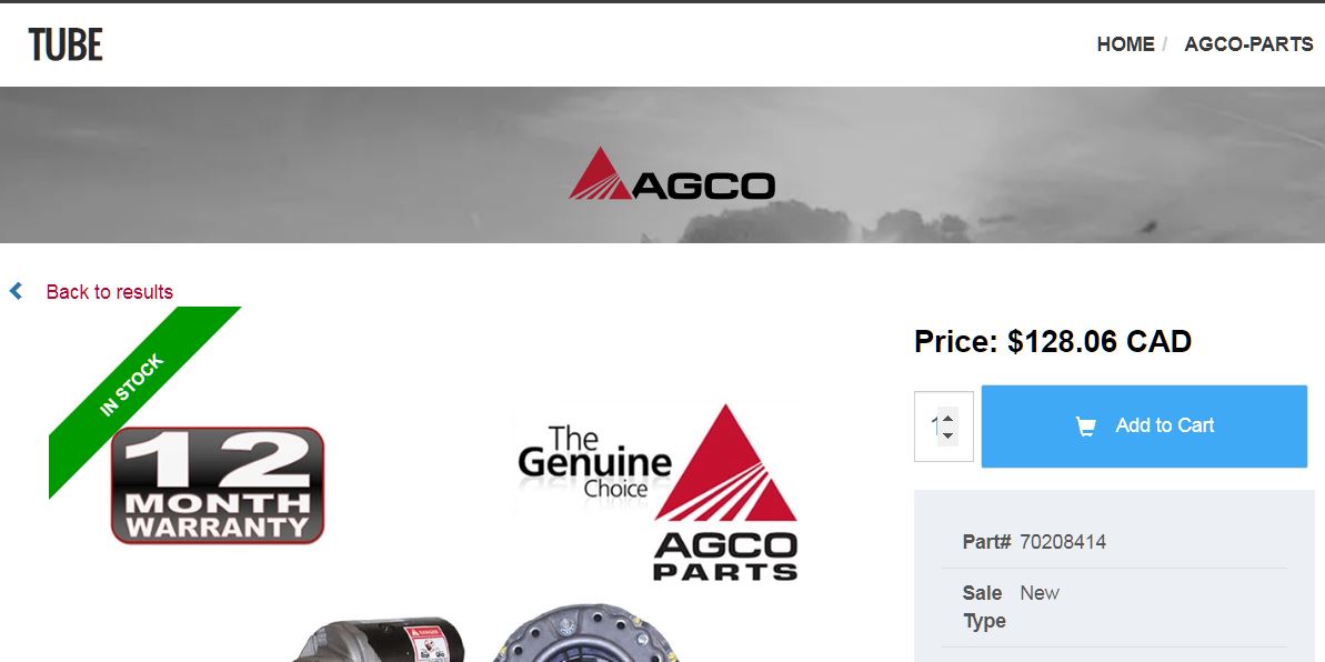

Post Options Post Options   Thanks (0) Thanks(0)   Quote seanb61 Quote  Post ReplyReply Direct Link To This Post Posted: 21 Sep 2022 at 9:01pm
Tracy, I called up the Agco dealer today, and they were able to look up the part number. But it is out of production and there is no stock at other dealers that they are able to get. And the only one I can find looking online is the one that Steve posted above, that is Canada. So it doesn't look like it is going to be an easy find at all to replace.

I would say buy that tube, $128cad is not that bad for a rare part.
