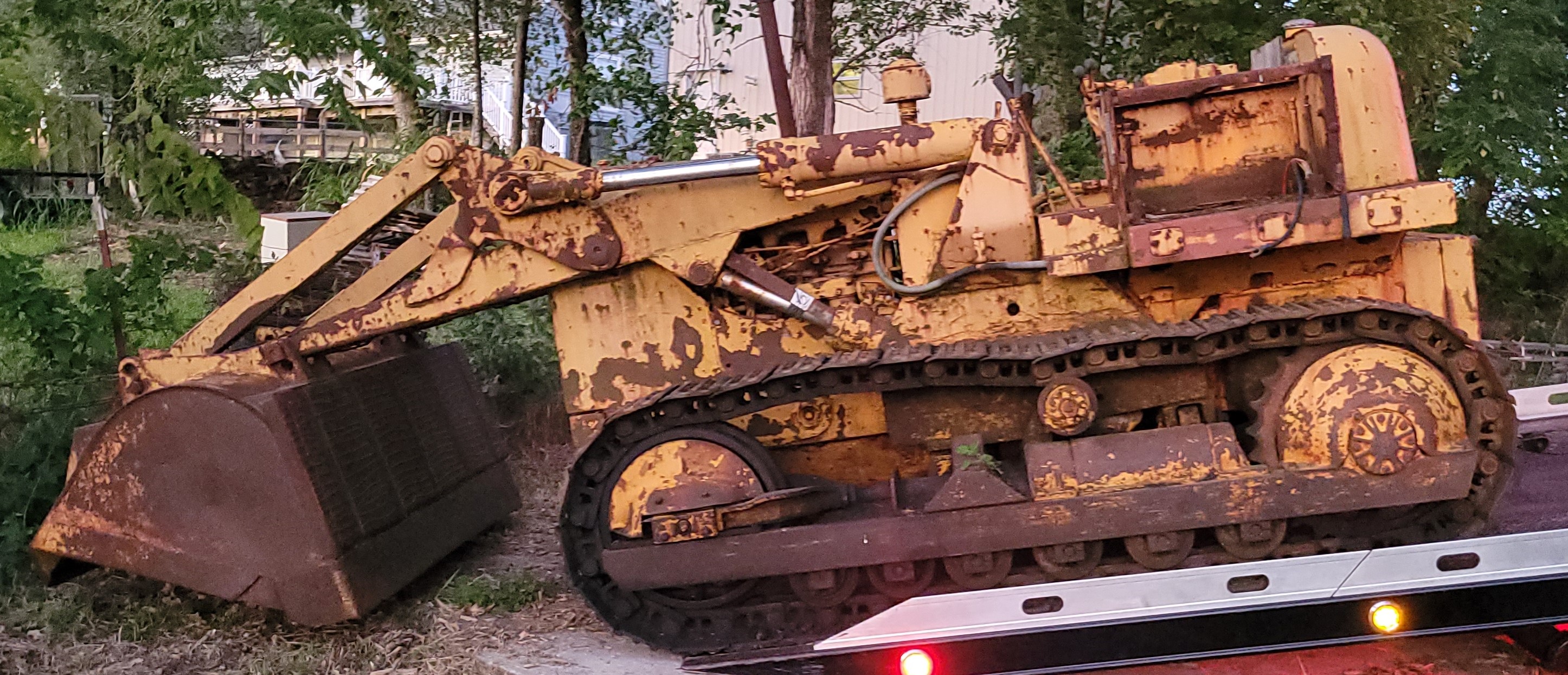

Well here she is, in all her glory. I told the tow company she weighed in at 16,000+, but the dispatcher told the driver it was 12,500. He must have looked up the Ag crawler specs and didn't know it had a loader and counterweights. That truck was bagging, but hauled it the 30 miles to my house. Seller said it had been down for 'a year' . My guess.....3-5 years. Many controls and linkages stuck, and the tracks wouldn't turn....seller assured me 'it would roll', they had 'moved it with a tractor several times'. HA! I figure the brake bands are rusted up. Anyways, has full oil with a lot of diesel fuel in it, hydraulic fluid is clean and full. Clutch is out. I wonder if diesel dilution in the oil will separate after setting for a long period? Will it float to the top? I'm going to change the fuel filters, flush the lines, put in some batteries, and see if this old B#$ch will fire up. As an old nostalgic mechanic who loves old machines, this is like a mystery novel. I feel like Dorothy finding the Tin Man and loosening up his parts with oil. I will find out all that the seller knew , but didn't tell me, and I will find out how much he didn't know, and why he couldn't keep it running.

if crankcase is full of diesel and it wouldnt stay running the transfter pump seal is shot.  hopefully it couldnt build enough fuel pressure and an easy fix.
gemdozer View Drop Down
Points: 1073
Post Options Post Options   Thanks (0) Thanks(0)   Quote gemdozer Quote  Post ReplyReply Direct Link To This Post Posted: 08 Sep 2022 at 10:23am
This machine look have good undercarriage on and about oiland fuel in pan you could just loosed the drain plug and let fuel comming out until you the oil comming and change the contenair  and you can see how oil was in pan

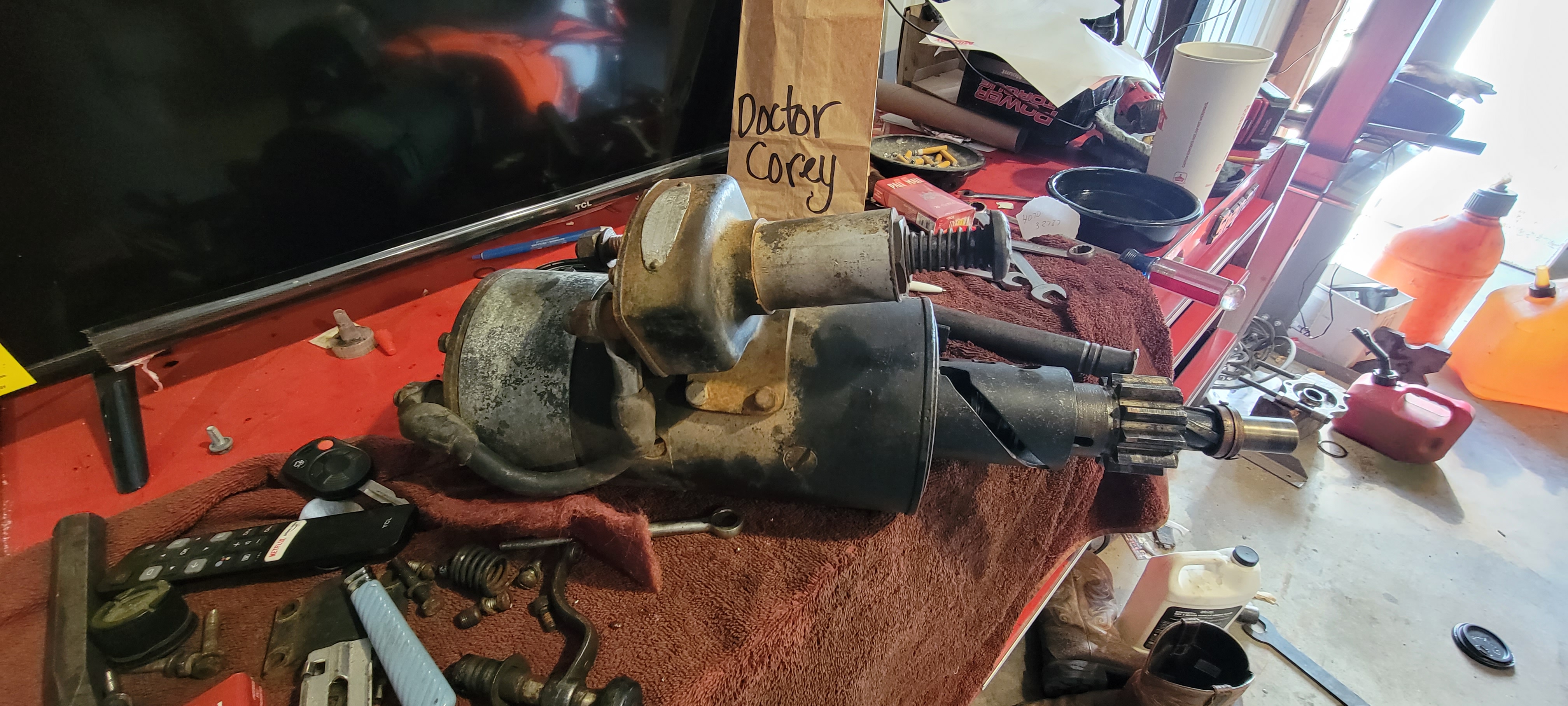

Can you post photos of the starter and parts; along with identification tag? I will be over to the rebuilder I use next week and can show them what you need. You may be better off replacing it however.
doctorcorey View Drop Down
Joined: 17 Jul 2011
Location: S. KC Missouri
Points: 589
Post Options Post Options   Thanks (0) Thanks(0)   Quote doctorcorey Quote  Post ReplyReply Direct Link To This Post Posted: 10 Sep 2022 at 11:24am
The only ID tag is on the manual contact switch. Hard to read  DelcoRemy 4070, or 4c7c....32737. Definitely has been rebuilt before, very clean on inside, and old punch marks. This little pawl on the bendix arm has been repaired before, I found an old clutch cylinder rod from my F250 that matches the two step diameter of this pin exactly, so I will make one if necessary.

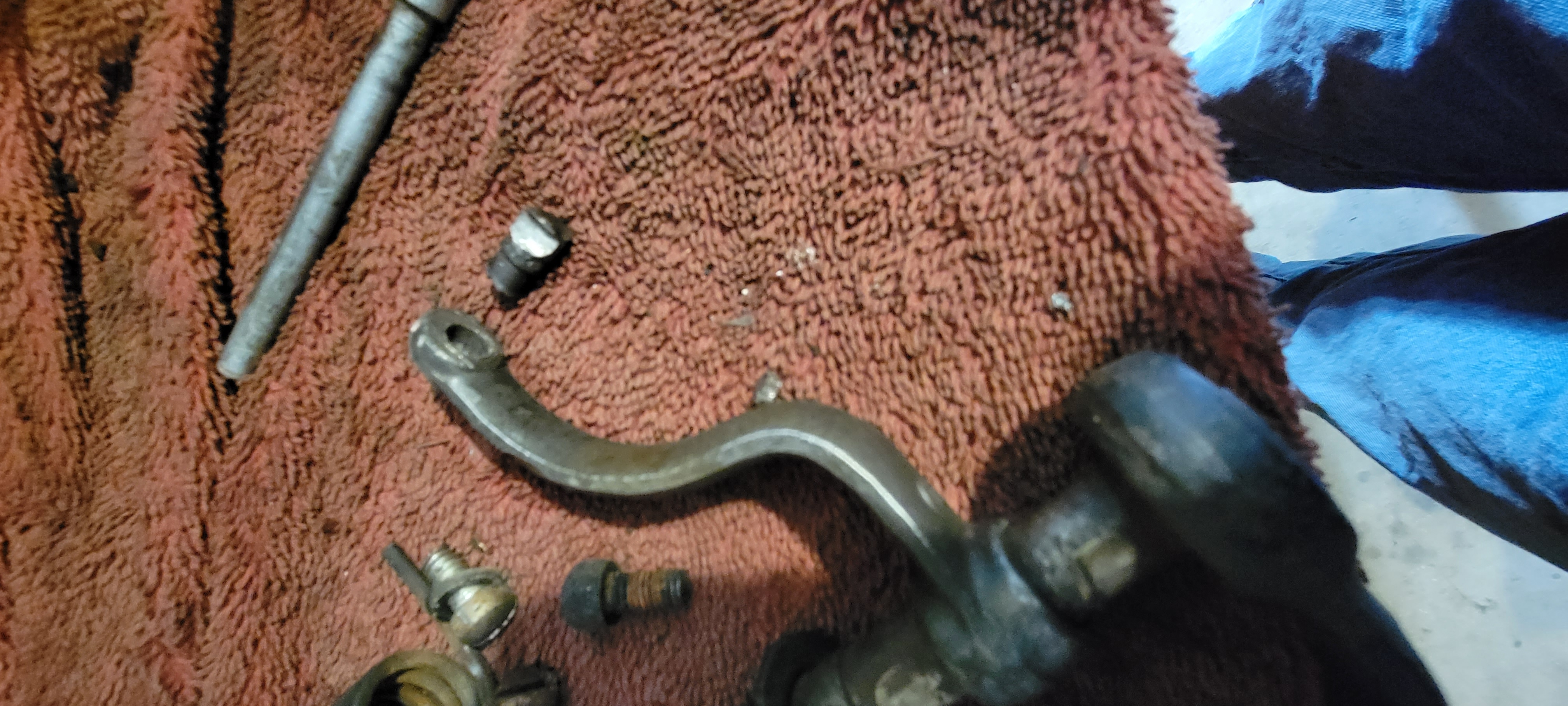

So, today I fabricated a new pin for the starter engagement lever, and reinstalled the starter. I then changed the fuel filters. About that time, it started to get cold and rainy. I got fuel to the primary filter, and figured I'd try to see if the starter would now work. Hit the plunger, and it spun over like a sewing machine. I cranked a few times for a total of probably 20 seconds. It sounds very even, like no dead holes. It started filling the oil filter housing, and sending fuel to the secondary filter. There was nothing in the cylinders that was combustion-worthy....I had went through the intake ports and added a mixture of ATF and Berrymans B12 before manually turning the engine over about 10 revs.  I had a small tin bucket over the exhaust, and I did get it to 'rattle' that bucket a few times. It was getting dark, and the rain picked up, and so did my beer intake. I'll get back to it tomorrow, and I think it's going to run. Thanks all of you for your help.

Reiterating - As it has been sitting for a questionable time make sure the pump is not stuck before you try to start it
  What about gaskets for the transfer pump. Are they paper, or o-ring, or ?
Semper Fi USMC    1958 HD6G, 1959 MF 203 loader, 1960 Case 420B Backhoe, MF 65 Tractor/Loader Diesel
Joined: 17 Jul 2011
Points: 589
Post Options Post Options   Thanks (0) Thanks(0)   Quote doctorcorey Quote  Post ReplyReply Direct Link To This Post Posted: 17 Sep 2022 at 9:38pm
Originally posted by Ian Beale Ian Beale wrote:
It has been about 15 years since I was in that area!
I don't remember there being anything special.
I was able to to get the pump out, turned it a bit to clear the elbow and out it popped. The seal was not hard, but a tiny bit of side play in the pump shaft was enough to let fuel pass the seal. Didn't disassemble the pump....seal was in tight but I got it out. I didn't want to mess with that 'shim' gasket between body and cover. Still hitting 90 degrees here every day, slowing me down at my age. I did discover today that the fuel cutoff control doesn't work. Plunger is moving full travel, but no shut-off. Guess I'll take a look in there and see which irreplaceable part is missing/broken. Cheers.
