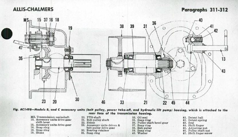

Post Options Post Options   Thanks (0) Thanks(0)   Quote steve(ill) Quote  Post ReplyReply Direct Link To This Post Posted: 24 Aug 2022 at 2:24pm
this is what the pto housing looks like inside... You can measure the TRANS FILL PLUG level and then check the back....... but i would assume the level is slightly BELOW the shaft level... most everything gets lube from SPLASH.
