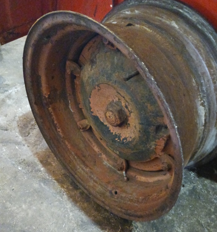

Just got a U in with what looks to me oversized rear rims. The rims are 14 wide by 28. Other U's that I came across are narrower. Is this an aftermarket rim or an optional style of rim.

Those may be A rims or someone widened them? I have a 37 U that has 18.4 28's on the back. I bought it with junk 10" rims, cut them apart and welded a 4" band in the rim. A U with 18.4 28's looks pretty mean

I’ve seen others with wider rims installed as well. Looking at the picture… Are there two valve stem holes?
