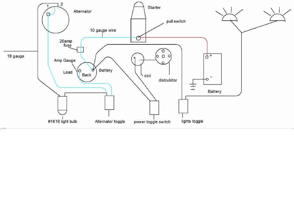

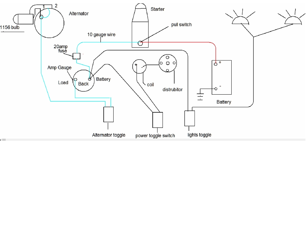

Hi to all guys and gals
I just signed up to your forum. I have been looking over the internet for roughly three weeks now for some help with the alternator issue on my 1956 Allis Chalmers model B. It has a distributor ignition, and a Delco 10SL alternator. For over 20 years I had a 1156 bulb and socket attached to the 12 volt battery stud on my alternator and it worked just fine. The thing is, when anyone walks up to the tractor, I get asked, "what's with the light bulb?" Then I have to explain what an idiot light is, and how it works.
So I moved the light, and added a smaller 1816 bulb to the amp gauge box. After moving the bulb, and starting the tractor. The bulb won’t go out and the system does not charge. If I disconnect it, and place the 1156 back on the alternator. It will charge just fine again. My guess is that my 1816 bulb is not large enough, or have enough resistance to excite the alternator. I really want to use the light bulb along with the amp gauge. For some reason, If I bypass the light bulb it won't charge ether. A read somewhere that using a momentary switch will excite the alternator. I wasn't so sure where to place it and if it would fry my alternator. Another suggestion was to add a resistor. I couldn't get a definite answer on what size resister would work and where to place it. Any help would be appreciated. I uploaded two sketches. The first picture is the old set up that second is the new. I hope the pictures loaded okay.
Thanks Jim

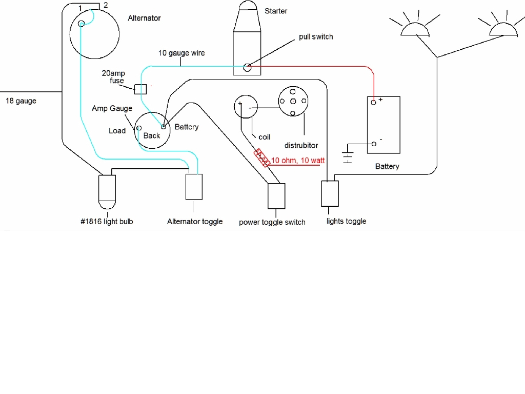

Post Options Post Options   Thanks (0) Thanks(0)   Quote steve(ill) Quote  Post ReplyReply Direct Link To This Post Posted: 17 Jul 2022 at 9:59pm
you can use a 10 ohm, 10 watt resistor... They are about 3/8 inch square and 2 inches long... Cost about $2.
you can use the same ignition switch or Toggle for the coil and the alternator...

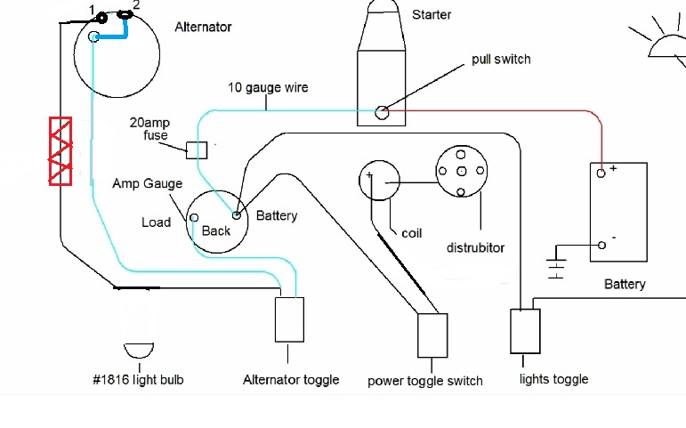

Post Options Post Options   Thanks (0) Thanks(0)   Quote Jimadelmacy Quote  Post ReplyReply Direct Link To This Post Posted: 17 Jul 2022 at 10:23pm
That was great, thanks for the quick reply. I looked at your drawing and added a resister to where it think it is supposed to go on my tractor. I gave it my best guess. Please take a look and see if I got it right.
Thanks again
Jim

Post Options Post Options   Thanks (0) Thanks(0)   Quote steve(ill) Quote  Post ReplyReply Direct Link To This Post Posted: 17 Jul 2022 at 10:45pm
no, the resistor goes in the #1  wire from the switch to the alternator..
is that circle in the alternator the BIG TERMINAL on the back ?? That should have  like a 10 or 8 gauge wire to CHARGE the battery.... and the #2 terminal is jumpered to it for power... not #1 terminal... #1 gets power THRU the resistor from the ignition switch.
look closer at the  #1 and #2 wires on my alternator..

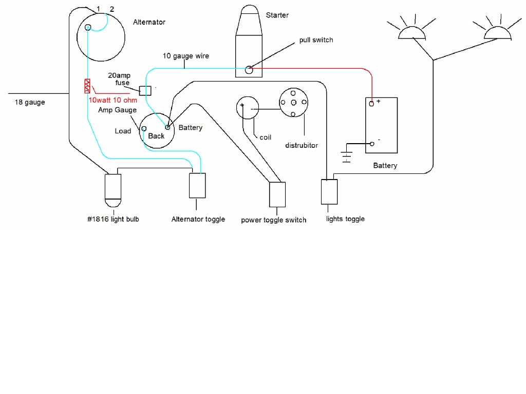

Post Options Post Options   Thanks (0) Thanks(0)   Quote steve(ill) Quote  Post ReplyReply Direct Link To This Post Posted: 17 Jul 2022 at 10:53pm
more like this... but you have the TOGGLE also on the MAIN CHARGE wire for the alternator... you dont need to shut it off... you CAN if you want, if your toggle will handle the alternator current ..

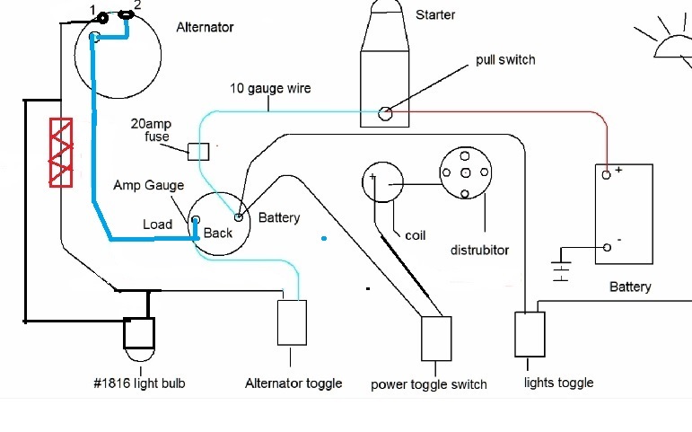

Post Options Post Options   Thanks (0) Thanks(0)   Quote Jimadelmacy Quote  Post ReplyReply Direct Link To This Post Posted: 17 Jul 2022 at 11:09pm
Yes the circle on the alternator is the is the big terminal. the blue wires are 10 gauge the black wires are 18 gauge. Sorry, It looks like I have the 1 and 2 wires shown on the wrong locations. The tractor is not set up that way. It's late and I was drawing from memory.

Post Options Post Options   Thanks (0) Thanks(0)   Quote steve(ill) Quote  Post ReplyReply Direct Link To This Post Posted: 18 Jul 2022 at 8:05am
NO.....your drawing shows the resistor in the 10 gauge POWER WIRE to the alternator.... The resistor should go in the BLACK 18 gauge signal wire to #1 terminal on the alternator..
You might be able to use the idiot light with the resistor.. You could try in in parallel with the resistor, and then try in series to see if it works correctly.

Post Options Post Options   Thanks (0) Thanks(0)   Quote steve(ill) Quote  Post ReplyReply Direct Link To This Post Posted: 18 Jul 2022 at 8:56am
YES... the BIG TERMINAL on the alternator should be HOT from the amp meter all the time... the #1 small terminal is switched ON and OFF by the ignition key or toggle...The resistor drops the 12v to the #1 terminal just enough to KICK IN and make it start charging.
