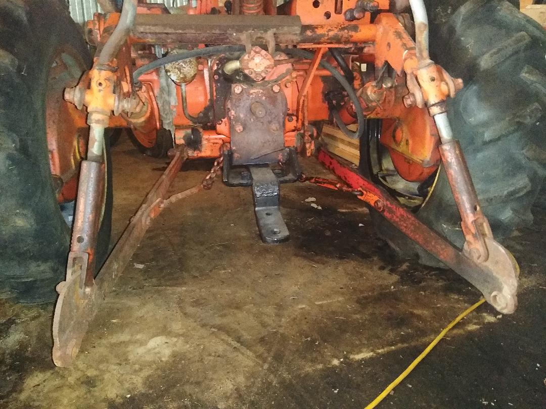

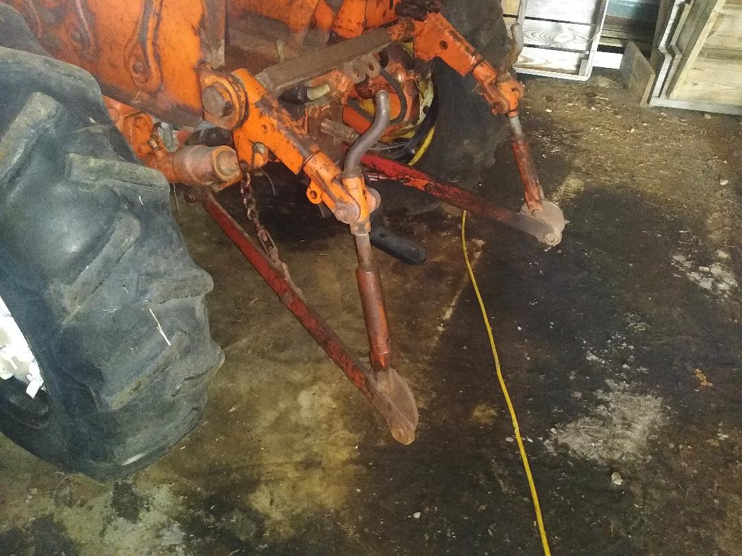

I bought a D12 Series 3 a while back and I am finally getting around to doing some work on it. It has a three-point hitch, but the lift arms are cobbled up.
The lift arms are 34" long and someone welded a piece at the very back to attach the adjustment (lift) arms, which I know is wrong. I am wondering if the list arms I have are the right length (34") and if anyone knows where the adjustment arms should attach to the bottom lift arms.
Here are a couple pictures.

Let the lift links dangle straight down, while the tractor is on a level surface.  That is about where the hole should be.  Those arms look ford/ferguson-ish, to me.Wink

lets say the pin was suppose to be at 24 inches ... and they welded the NEW point to 32 inches ( from the anchor under the rear end)....  32/24 = 133% ( 33% MORE)........ I would guess they had some HEAVY 3 point tool and wanted MORE LIFT POWER to raise it.. Moving the pin BACK will give you MORE LIFT POWER... but less TOTAL LIFT INCHES..

Thank you guys! You have given me some ideas!
