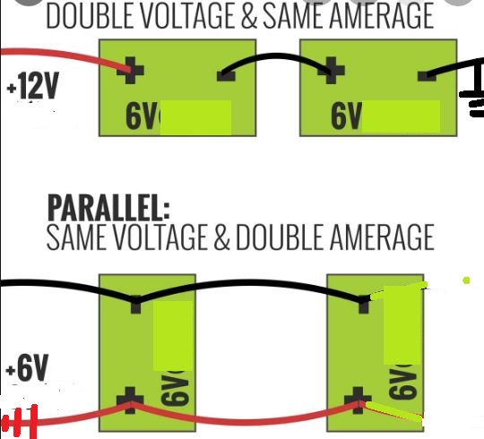

I have a WD 4 diesel with two 6 volt batteries and I'm not sure they are hooked correct. Need some help on this. Thanks
Points: 87219
Post Options Post Options   Thanks (0) Thanks(0)   Quote steve(ill) Quote  Post ReplyReply Direct Link To This Post Posted: 28 Jun 2022 at 11:06pm
If you want to have 6 volts with DOUBLE the CURRENT, then you connect the two POSITIVE terminals together and ground them.. You connect the two NEGATIVE terminals together and run that to the starter..  ( 6 volt positive ground system). ( parallel connection)
If the batteries were connected to form 12 volts ( negative ground system)... then you GROUND one negative terminal on battery #1... you run the POSITIVE terminal of #1 to the NEGATIVE terminal on #2 battery.... you run the POSITIVE terminal on battery #2 to the starter..   (series connection)

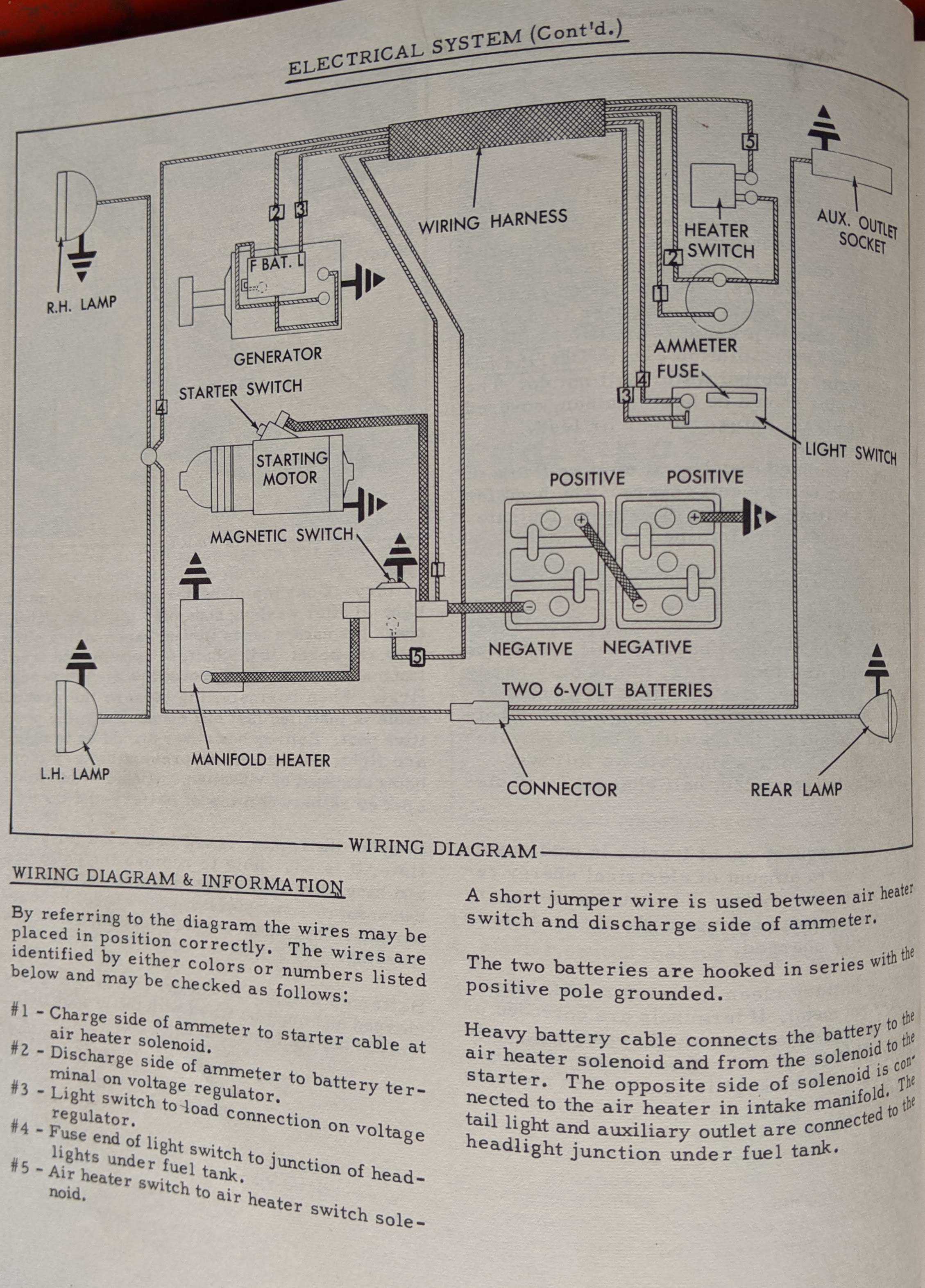

This is from the original WD45D operators manual.
Points: 87219
Post Options Post Options   Thanks (0) Thanks(0)   Quote steve(ill) Quote  Post ReplyReply Direct Link To This Post Posted: 30 Jun 2022 at 12:28pm
so original was two 6 volt in series , or 12 VOLT.... but still Positive Ground..
TomMN View Drop Down
Location: Elbow Lake, MN
Points: 858
Post Options Post Options   Thanks (0) Thanks(0)   Quote TomMN Quote  Post ReplyReply Direct Link To This Post Posted: 30 Jun 2022 at 1:04pm
Yes, positive ground and 12 volts. The D17 Diesel is that way too, two 6 volt batteries in series with positive ground.
rodnil View Drop Down
Points: 247
Post Options Post Options   Thanks (0) Thanks(0)   Quote rodnil Quote  Post ReplyReply Direct Link To This Post Posted: 01 Jul 2022 at 9:47pm
Thanks guys for your input. My fears that my WD 45 diesel batteries were hooked up wrong was incorrect. they are just like the info you provided. Thanks, Rodney.
