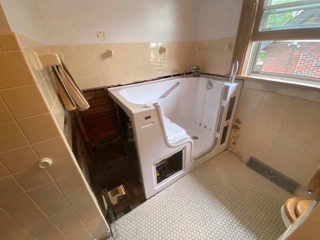

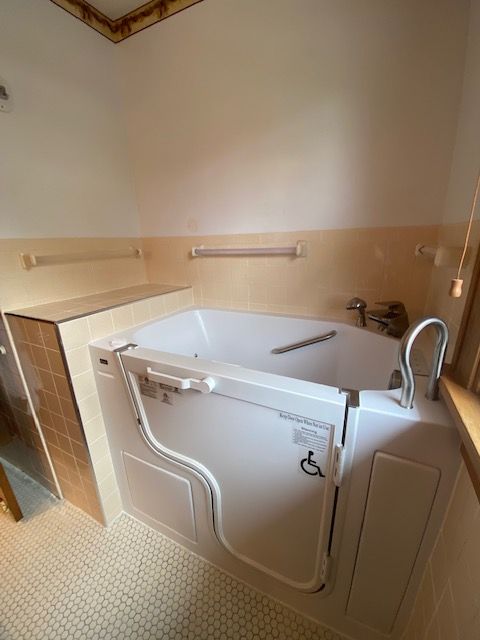

Started this on Monday.  First cut the tile just above the new tub height, then remove all tile and old tub below that cut line. Then level the walk in tub setting on the subfloor.
Plumber hooks up the drain and water lines, after which I start filling in the old tub space.  Electrician comes and hooks up 2 circuits  and then its all up to me!   Fill in the tile and grout.  When done on Thursday:

Nice work. Must be a hell of a latch on that door. Not seen one like that
