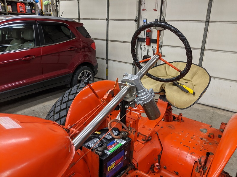

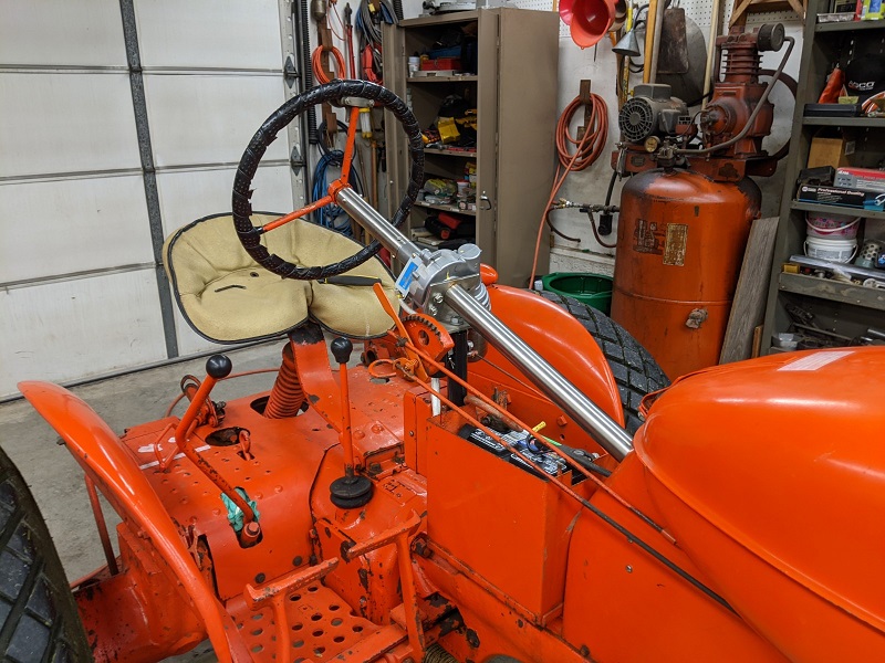

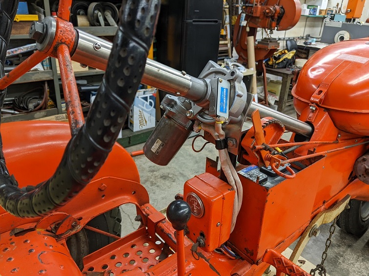

I completed this project over the weekend and thought some might be interested.
I use the CA and Woods L306 to mow about 2 acres every week.  It does a great job and it's fun to use but my old shoulders are tired of the manual steering, so it was time to do something about it.  I had thought to add a hydraulic system, but finding a place to mount the pump was a problem I just couldn't solve easily.
Several years ago we built a 1965 Ford Econoline and retrofited it with an electric steering unit and electronic control box from a 2007 Toyota Prius.  It worked well except there is no feedback feel from the road and it is a bit different to drive as it will not return to center automaticly by itself, it has to be physically steered.  But the steering force required is almost effortless.
I had a couple of units left over from the Econoline build and thought I might adapt the concept to the CA, and since it has to be steered both ways anyhow, the lack of automatic return to center would not be an issue with the tractor.
The result was better than I imagined.  Effortless steering.
Here are some photos of the project.

Should work GREAT for your shoulder.... YEP, biggest problem with the B- C  CA is there is NO ROOM to do anything, except up by the steering wheel.
Points: 87090
Post Options Post Options   Thanks (0) Thanks(0)   Quote steve(ill) Quote  Post ReplyReply Direct Link To This Post Posted: 18 Apr 2022 at 1:27pm

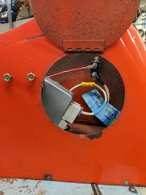

Bret, give a little description of what is going on INSIDE the unit with the ORIGINAL SHAFT.... Did you have to cut the shaft and have an IN and OUT shaft, or is there a gear that slides over the shaft and LOCKS to it that the motor drives ??
You have two wire harnesses by the steering wheel... One for the motor, and is the other a MOVEMENT SENSOR or something like that ?  I assume something is talking to the "BOX" in the tool box and it is then telling the MOTOR to rotate ?

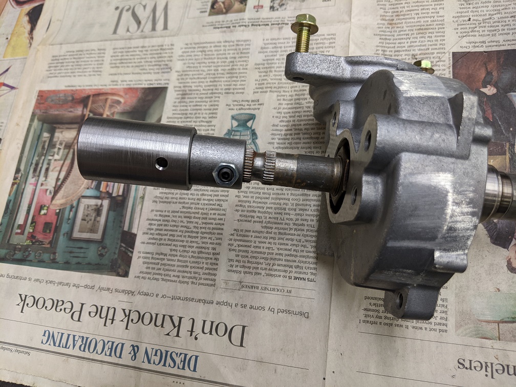

Cut steering shaft below electric steering unit. Used a borgeson coupler 11/16-36 spline to 3/4. Machined out to 7/8 for Allis shaft. Welded coupler to shaft. Above unit used Prius shaft, cut keyway for Allis wheel. Can all still be disassembled.
Sensor talks to electric brain box, box sends power to motor according to signal for left or right.

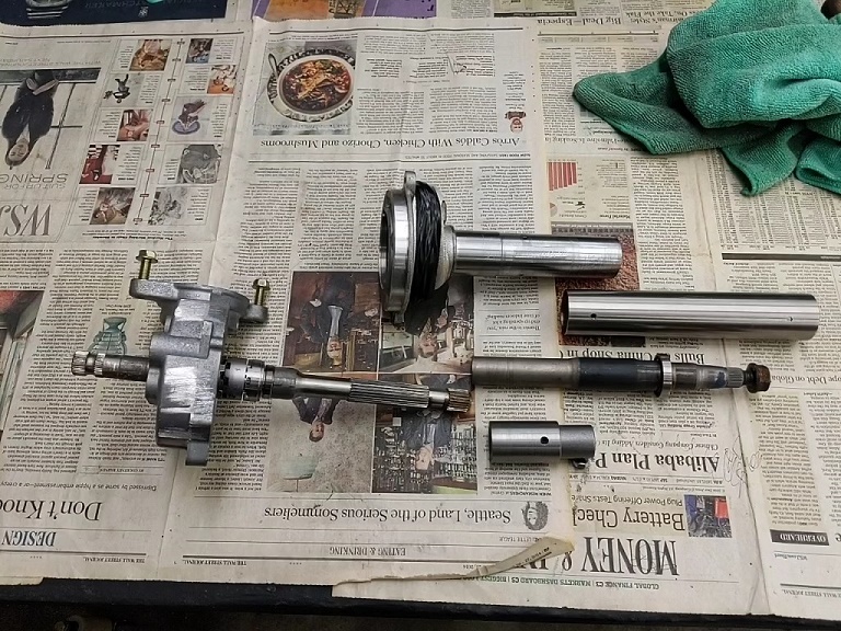

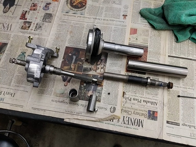

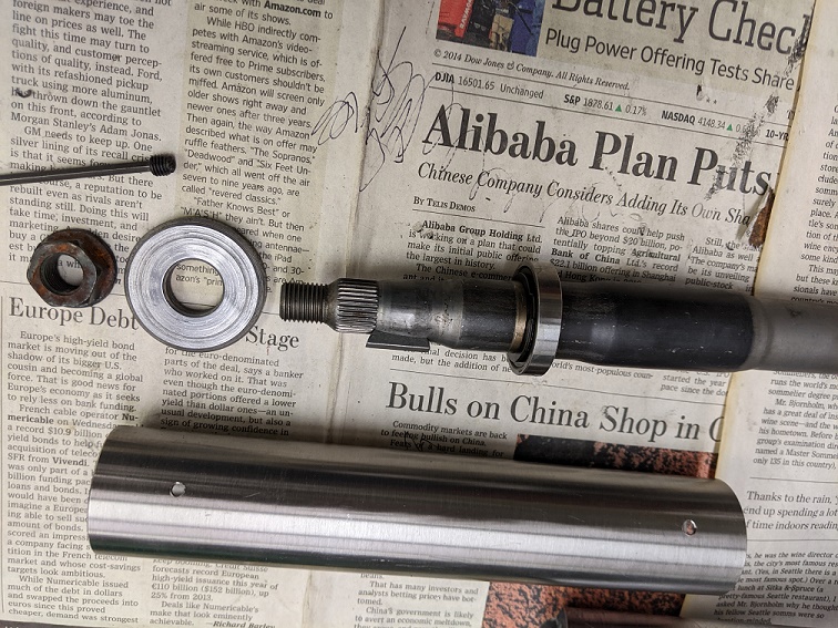

Here are some photos of the components.  I machined a secondary coupling for the lower shaft to go over the Borgeson splined coupling that I bored out to .875" since that left the splined coupling thin on the end that fits over the Allis worm shaft.  The set screws hold the coupling in place for positioning then after adjustment I welded the couplings together and to the Allis shaft.
The thick washer goes above the steering wheel as a spacer to allow the Prius nut to tighten the steering wheel onto the upper shaft.
I have ordered a shaft oil seal to be installed at the upper end of the column, just below the steering wheel to seal for water intrusion into the upper bearing on the upper shaft.  It's a weird dimension, so I'm not sure the seal I ordered will fit properly.  The bore is 1.377, and the shaft is .860.  The closest seal I could find is 1.375 x .866.

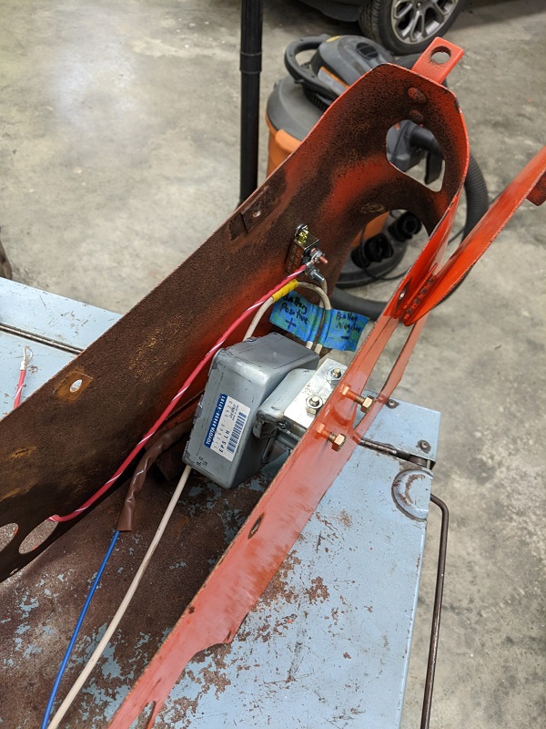

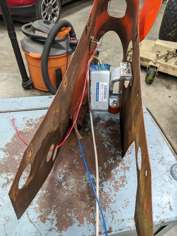

Post Options Post Options   Thanks (0) Thanks(0)   Quote Bret (OH) Quote  Post ReplyReply Direct Link To This Post Posted: 22 Apr 2022 at 5:05am

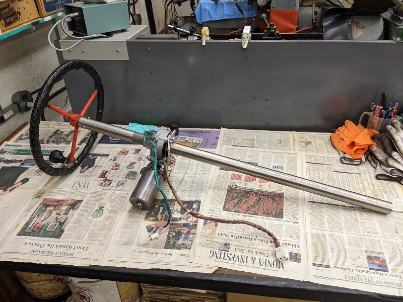

Only (2) toyota parts are needed, the steering assist assembly, and the control box.  The control box has 2 large plugs and 2 small plugs.  The 2 large plugs are for + and - from the battery, and the power feed wires from the box to the EPU.  The 2 smaller connectors are communication wires from the EPU to the control box (the smaller plug as I remember) and a wire from a key on source (the larger small plug) to the control box to tell the box to power on when the key is on, so in this plug only one wire is used and the rest of the pins are ignored.  With this setup when the key is first turned on there is a 10 second delay as the unit initializes before power assist is available.
Be sure to get the plugs and some wire from the doner car to ease installation.  The wires will need to be modified in length to accomodate mounting locations of the components.  I also used the upper steering wheel shaft and bearing from the Prius.
The steering columns are made from 1 1/2" stainless tubing that I had from another project.  Its wall thickness was .060.  I bored out the tubing to fit over the CA steering box, and to accept the diameter of the upper bearing and 22X35X7 HMSA10 seal at the steering wheel end.  I also bored out the upper tube and turned down the upper extension of the EPU so the 2 parts would fit together to form the upper column.
