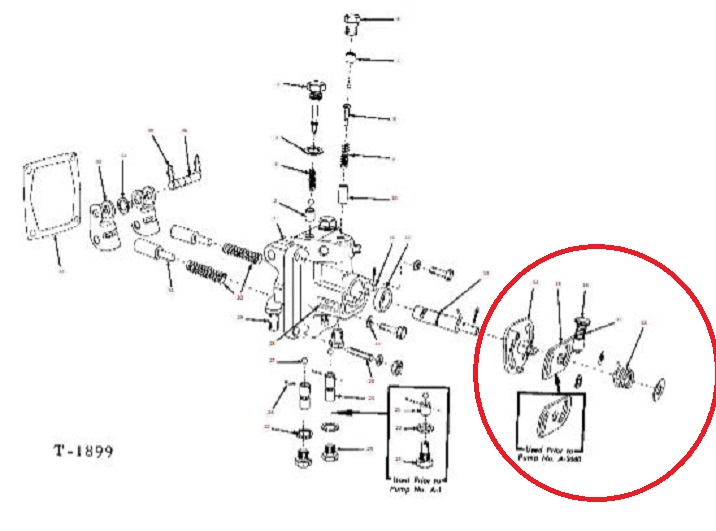

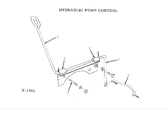

the LOOP is the handle you pull on... the hinge bolts to the bottom of the seat... The second ROD below is what attaches to the cam on the end of the valve/pump shaft... If this is not enough, i can get a PHOTO of a real tractor if needed.

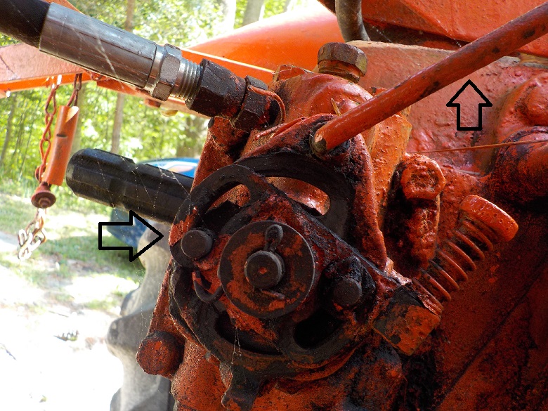

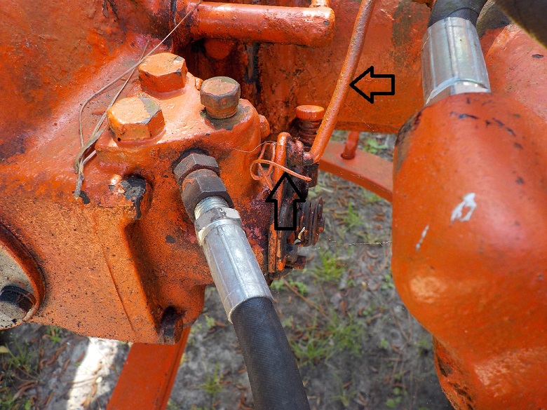

doesn't work. I am trying to get pictures of what I have uploaded. The straight arm in both photos is the control arm. the other 2 arrow 1 is pointing the spring loaded adjustment screw that doesn't control much that piece moves all over the place. The other arrow show a small piece of wire, looks like metal coat hanger bent up to try and make it work right but it doesn't. Maybe i can just replace parts of it, not sure the best approach. Thanks for your help ![]() ![]() |

the 12 year old link that mdm1 lists above has some good data.. You might want to read the first couple pages of posts concerning the the "two plates" in your photo.
Basically your second photo shows two round plates on top of each other mounted to a shaft... there is a spring and clip that holds them on... Dont pay much attention to the adjustments screw and its spring right now... The two plates move relative to each other, them must be FREE to rotate and not stick.. Rust, paint, crud in this area does not help. .. Soaking both with penetrant and running them back and forth by hand might help.. On plate moves 10- 20 degrees, then grabs the other plate to rotate it... If they are not moving FREELY from each other, that is a problem.. poor picture, but this is the area to look at.. Edited by steve(ill) - 23 Apr 2022 at 8:20pm |
Bobby G. ![]() Bronze Level ![]() ![]() Joined: 12 Mar 2022 Location: 28560 Points: 5 |
That was helpful, I am going to try to get them to move independent of each other.
