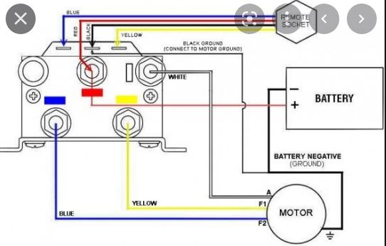

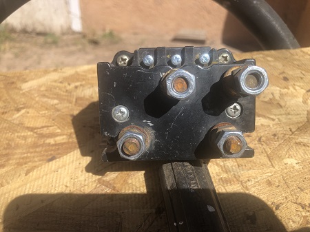

 OK, this one is for them FRIENDLY juicetricians on here.. Thiswas in the box of parts with the winches and I believe it may be a solenoid of sorts for the controller. I find lots of these on the net but with different hook up patterns,,,!! This one has NO letters, NO Numbers NO nuttin,,,how does one figure which is what,,?? It haas 4 big lugs on top and 3 small screws on side like maybe for the 3 wires on most controllers,,,??

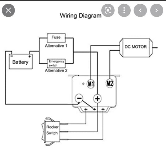

easy, peasy....
my wild guess...
...based on the center small screw IS connected to the big stud below it ( check with ohmeter...)
push button goes between small left screw and center one ( call this 'winch in')
push button connected to small right screw and center screw( call this 'winch out')
stud under center screw goes to Battery +12
stud right of it goes to battery - ( ground)
stud lower left goes to winch red wire
stud lower right goes to winch blk wire
how it works.
when you push 'winch in' , a relay(solenoid) goes clunk, connects +12 battery to lower left stud AND ground to lower right stud, motor spins, cable pulls in....
when you push the 'winch out' , the other relay  goes clunk, connects GROUND to the left stud, and +1 to the right stud, motor spins  in reverse, cable goes out.
You should put a 40 amp resettable circuit breaker between battery and the +12 stud.
I'll have to check one of mine, but that 'should' work....
jay

As Jay said , the small terminals are IN on one side and OUT on the other side.. the center is GROUND....
The 4 BIG LUGS are for Battery power and to the motor terminals... There are two types of motors.. See if you have the standard 3 terminals lugs or  if it only has 2 terminals ( the case is always ground)...
