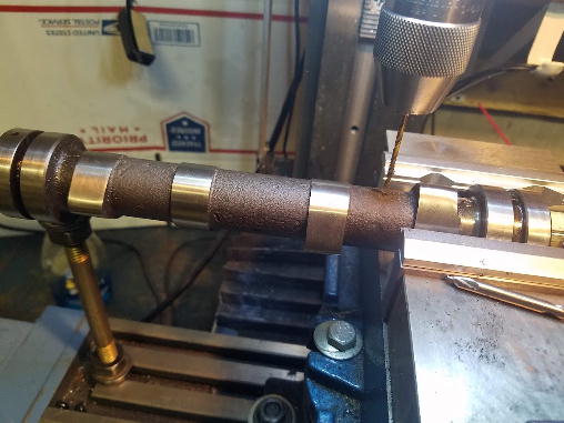

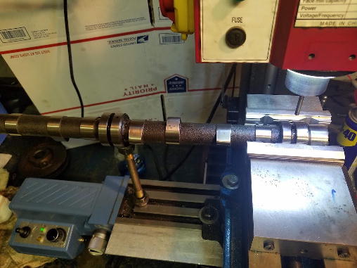

Now comes the fun part. Before I reinstalled the cam, I noticed that there were no squirt holes in the camshaft for oiling connecting rods. So, I took some measurements and drilled the holes, cleaned, and oiled it again, and reinstalled.
I'm glad that I noticed the lack of holes. It would have been a catastrophic failure.

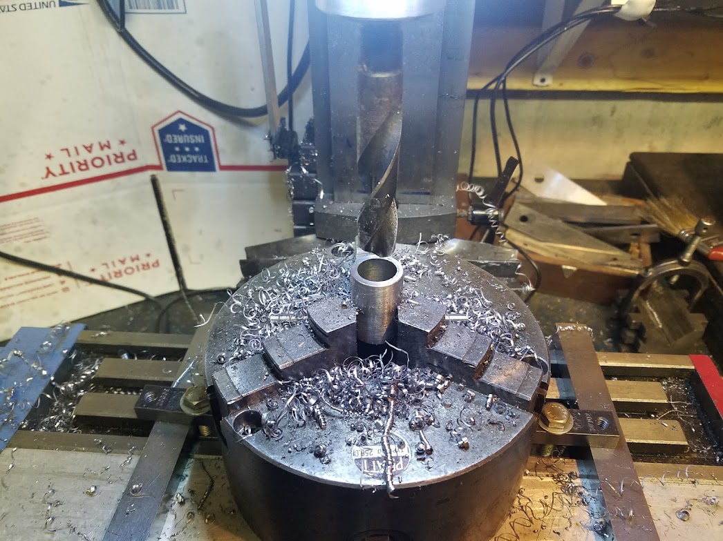

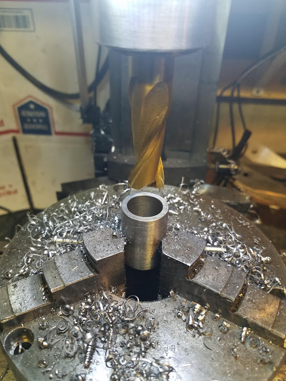

I spent some time while recovering from surgery, reworking the camshaft for my A/C B. I want to send my sincerest thanks to PaulB for his advice.
I placed a piece of 7/8 diameter round stock into my 3 jaw chuck. I brought into height so it is flush with the end of the camshaft. I drilled it out and placed a flat counter bore at the bottom of the hole for a place for the spring to rest. I have no idea what the original length of the thrust plunger was, so I set the plunger at the same height as the one from the old cam.
