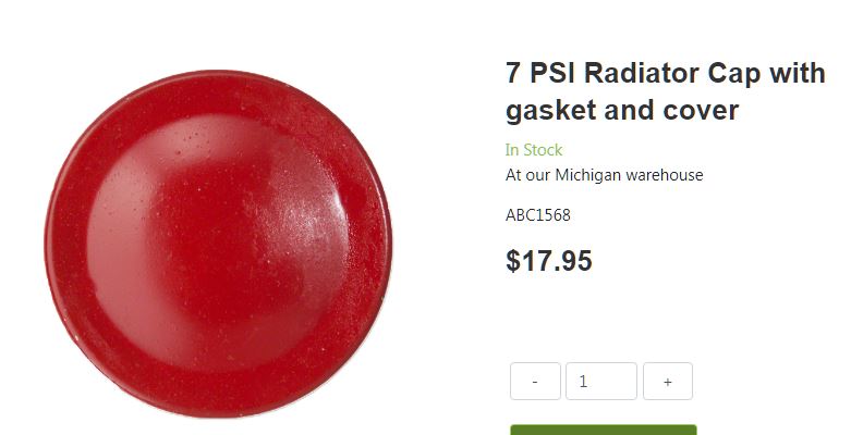

Post Options Post Options   Thanks (0) Thanks(0)   Quote steve(ill) Quote  Post ReplyReply Direct Link To This Post Posted: 20 Feb 2022 at 8:35am
If you want the ROUND cap it is ABC1568
Edited by steve(ill) - 20 Feb 2022 at 9:14am
Points: 90532
Post Options Post Options   Thanks (0) Thanks(0)   Quote steve(ill) Quote  Post ReplyReply Direct Link To This Post Posted: 20 Feb 2022 at 8:38am
If you want a cap with EARS it is ABC1396

Who is the manufacturer of the ABC numbered caps? I am thinking the ABC numbers are from an aftermarket supplier, used by the aftermarket vendors as shown in the list you posted.  That ABC1396 doesn't cross in Gates and it would seem it should if it is an industry standard number.  Just curious about their source.
