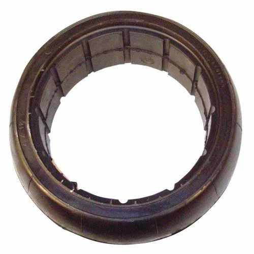

Looking for a gauge wheel tire source for an Allis G Independent Gang Cultivator. Same design as the common 4" x 12" gauge wheel tire except 3" x 8".
Checked with some manufacturers, no can find.
Picture is of the common 4" x 12" tire.
Any help will be greatly appreciated.

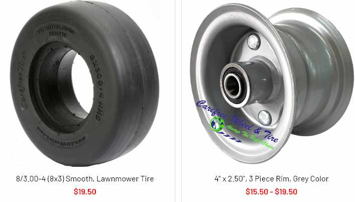

I have considered these as replacement wheels.
Make new axle bushings from DOM 3/4" OD x 7/16" ID.
If you try that route, let me know how it works out.
K-Mo
Points: 54699
Post Options Post Options   Thanks (0) Thanks(0)   Quote DiyDave Quote  Post ReplyReply Direct Link To This Post Posted: 30 Jan 2022 at 5:18pm
Still, come monday, give miller a call.
Your first link was non-specific, so I don't know which of the wheels you were considering.
You may find on new wheels, that most have a 1-1/2" hole in them, if so, then all you have to do is to find the right bearing, or something close, and bush the bolt...
A word on chinese rubber.  even new it has a shelf life of about 5 years after exposure to light of day...Wink

Tire 3" x 8"
Hub 3/4" x 3"
https://carefreewheelandtire.com/
Points: 54699
Post Options Post Options   Thanks (0) Thanks(0)   Quote DiyDave Quote  Post ReplyReply Direct Link To This Post Posted: 30 Jan 2022 at 7:39pm
Close, but it looks chinese, to me.  See note, above.  That hub looks like it has the knock out bearings that are likely 1-1/2" OD.  TSC generally has these in other ID (bore) sizes, easy to change it for the right sized bearings...Wink
