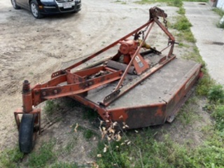

Post Options Post Options   Thanks (0) Thanks(0)   Quote Kruger Quote  Post ReplyReply Direct Link To This Post Posted: 09 Jan 2022 at 6:32pm
No photo description available.

Marketplace - Snap Coupler Pull Type Brush Hog | Facebook
The forum will not let me post a picture, but here is the link.
Points: 5490
Post Options Post Options   Thanks (0) Thanks(0)   Quote AC720Man Quote  Post ReplyReply Direct Link To This Post Posted: 09 Jan 2022 at 7:18pm
Looks like someone took a torch to the center hitch member? Looks like a jagged cut to me if I’m seeing it correctly.
Points: 55340
Post Options Post Options   Thanks (0) Thanks(0)   Quote DiyDave Quote  Post ReplyReply Direct Link To This Post Posted: 09 Jan 2022 at 7:30pm
That sure as heck looks like a Bush-Hog maybe model 205 or 305, not AC!  Bush hog sold a lot of their equipment with a kit that would fit an AC snap coupler. Look at the the rear of the unit, in your pictures, I think I see the Bush Hog logo, on the left rear side.   I would get on google, and look at some pictures, try Allis-Chalmers LaPorte (or Danuser) bush hog images, as the search term. Or when you go look at it, see If you can find the model/serial # plate, should be on the cross member, just under the gear-box.
Don't get me wrong, here, nothing wrong with a Bush-hog mower, and the price seems reasonable.  I would, however see if I could find the friction clutch, complete.  This one appears to be a shear bolt model.  Good news is that Bush Hog will still sell you parts, and there are lots of them out there, in junkyards, like Yingling's, in Gettysburg...Wink
Its also possible that that's a Home-made SC!  Look at the welds, positioning of the members, and bent pipe towards the rear end of the hitch, front view!

I never saw a AC brush cutter that looked like that. pTO different, reinforcement run wrong direction, gearbox different, and many other things. I would keep looking if I wanted a snapcouppler.                          MACK

After researching older models of brush hogs, zI think DIY DAVE is right. I think somebody took some hillbilly engineering to add a SC to an old Brush hog. Thanks again for all the info.

Definitely a bush hog mower with modified hitch. Ive got that exact mower. The gearbox and skid runners are a dead giveaway.
