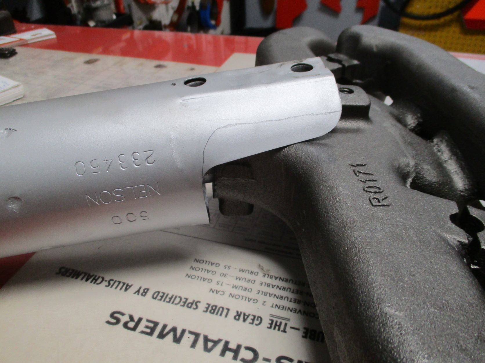

Here is the Nelson muffler on an aftermarket D14/D15 manifold. Looks like the rain shield would have to be trimmed to slide the muffler into the manifold. From the way the manifold is shaped, looks like the original D14/D15 manifolds would have the same problem. I will test a muffler on an original manifold when I get a chance.
On the WD45/D17 aftermarket overseas manifolds, the square bosses that have the threaded holes for the muffler bolts need to be ground down so the Nelson muffler can slide all the way on. (The square bosses stick out too far) That doesn't appear to be the case on the D14/15 though.

Tracy , the Nelson inlet tube is 1.25 " long . My Stanley has 2.25" inlet . I also pulled my O.E. manifold out of the scrap pile and put it in my vise . Nelson muffler won't slide into place on it either . In all fairness I have "fine tuned" the skirt a little . I'm moving on to something else before I really make a mess . THANKS

Finally got the Nelson muffler on . Trimmed the rain skirt , ground the outside exhaust manifold threaded bosses down. Got the muffler on but it wouldn't go down far enough for the bolt holes to line up . Had to grind a little notch in the inside of the muffler O.D. where the inside manifold boss was hitting . Happy to say it sounds better than the Stanley . Thanks
