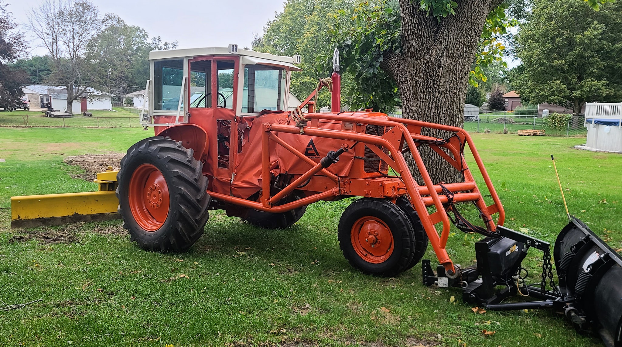

I recently acquired a 1949 AC WD, and decided I would use it for the upcoming winter to clear snow on residential drives and smaller businesses. While my Excursion does well for larger lots, its a bit cumbersome when it comes to short runs such as driveways.

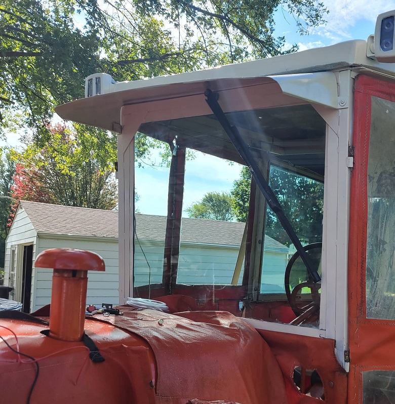

To that effect, I searched around a bit and found the Original Tractor Cab. The owner stated it was off of a 180, and it seems to be a universal style as it's adjustable in height and width to a degree. The door vinyl will be replaced soon, but overall I was pleased with how it fit on the WD. Entry in the side door takes a bit of finesse, but it beats freezing to death! The heat housers came with it, and seem to be quite effective at warming up the cab.
A wiper and defrost fan are on order, then I'll install some side mirrors and a backup cam for better visibility with the rear blade (and less neck strain).

Doesnt take much to stay warm if you're out of the wind

I was wondering if the snow is blowing, would that cover the camera, or at least the lens frame?

It can in the right conditions, on past equipment I usually spritz the camera with some Rain-X. That, coupled with the engine vibrations, tends to keep it pretty clear.

Congrats on a great looking setup.  That WD has combine wheels on the rear instead of the traditional Power Adjust Wheels (PAWs).  I think it's cool for your son to get dropped off too!  Have you promised him it'll be HIS tractor in a few years?  LOL

Awesome! The WD can really push and stack snow! With double ring chains on she’s a beast!!!
Yes it had the combine wheels on when I bought it, the tires are in decent shape so we will run these for awhile.
We are about to find out! I'm going to load the tires and sipe them first to see how it does. I try to avoid chains as it tears up customer's drives and we usually (knocks on wood) don't get a lot of ice. If that doesn't work, I may shoot some grip studs branded carbide studs into the lugs to give it a little extra bite without the rough ride of chains on pavement.

I also installed the windshield wiper system today. The kit came with 2 washer nozzles, so the plan is to install one on the windshield and one on the rear window to keep everything clear.
