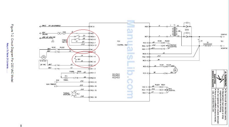

I have a Millermatic 175  wire feed welder that feeds gas as soon as power switch is turned on, only should feed gas when trigger is pulled, wire does not feed until trigger is pulled.   Checked leads on gas valve coil and has 240 volts as soon as power switch is turned on.  Anyone have experience with this problem??????

Tim... i believe the unit has a control board... Power goes into the board.... control switch feeds into the board.. output is to the wire feeder... another output is to the gas valve..
If all this is correct, you might have a control board problem.. Look at the gas valve wires and see if they both run to a circuit / control board... If yes, the BRAIN is on the board.

closeup ............. gun trigger shows 2 wires... dont know if that is two switches ( one failed ??) .... or if two leads for one circuit ??

Steve, the wires for gas valve do come from control board,  I've looked the board for discolored or burn mark finding none.  Thinking of installing a relay with 24v coil using wire from gun trigger and a common and breaking the gas valve circuit with the contacts.

that would work... the only other question is the gun trigger... is it actually TWO switches, one for the wire and one for the gas... ?  You might unplug ONE of the wires at a time and see if the other wire actually controls something...... what if it is two switches and one is STUCK ON causing the gas valve to say open ?

Update..............  After messing with it for sometime decided to re install board hooked everything back as should be,  gave it a try, works as it should.  I think relay contacts are sticking, if I can determine which one will try changing it.  Miller isn't very forth coming with diagrams.  Thanks for the response!

Gas valve is probably sticking, usually the case with those little Millers, never had a problem with the electronics in that respect.

I second Ken's assessment- it is more likely that the gas valve got a little bit contaminated, and it managed to free itself.  It is NOT a high pressure valve, nor is it a very powerful electromagnet.  A little contamination will prevent the cutoff needle from seating... a few cycles of the gun frequently knocks it clear.
