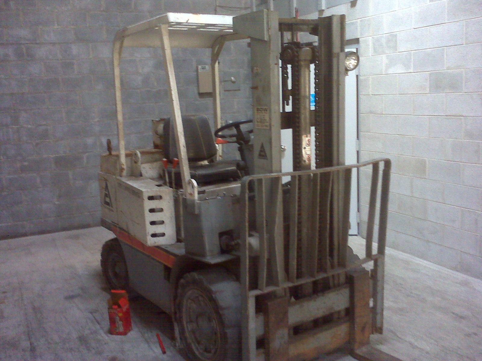

Hello,
I just bought this hilo, didn't have an ID plate. I was wondering if anyone out there could tell me the model. Its a diesel, two stage mast, I'm guessing 9000 pounds. Any help is appreciated.

looking at it's size i would guess in the 5000-6000# range, not big enough to be a 9000#. what does the tag on the right side of the boom say?

That machine is either a 5 or 6,000lb truck. It is a pneumatic. That makes the model either an ACP50 or 60. It also has those 4 lifting eyes on it,possibly making it a stevedore machine or ex-government. Open the right side door and the serial number is on the chassis.
This is one of the last true American made AC's. Mid 80's vintage!

Nice looking unit!!
Points: 24728
Post Options Post Options   Thanks (0) Thanks(0)   Quote jaybmiller Quote  Post ReplyReply Direct Link To This Post Posted: 03 Feb 2011 at 2:45pm
Nice, I've got a 5,000# diesel older looking than yours but REAL handy.
I see the bottle jack...If you need to remove the front tires I was told by another A-C guy to tilt the mast back all the way, then put a solid timber underneath the bottom of the mast,then tilt the mast forward. 'magically' it'll raise the wheels just off the ground!
