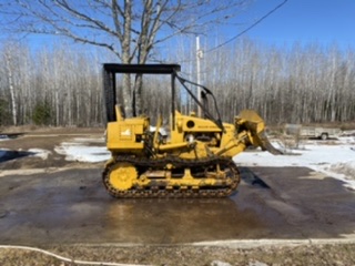

One more cry for help here. Ran the dozer last night, snaps into reverse just as good as it does in fwd. Then sometimes it’s a bit sluggish or slipping (only in reverse). Mess with it back and forth and can usually get it to snap into reverse full power again, I’m very confused on what could be going on. Does seem like maybe it happens a little more once it warms up. Any help is appreciated! I had an earlier post here but wasn’t getting any replies

I'm no expert on these transmissions but by principle it sounds like the seals for the hydraulic pressure governing the reverse clutch are compromised. I've had the same scenario in the long past, amazingly enough it still just kept on going without a distinct breakdown.
