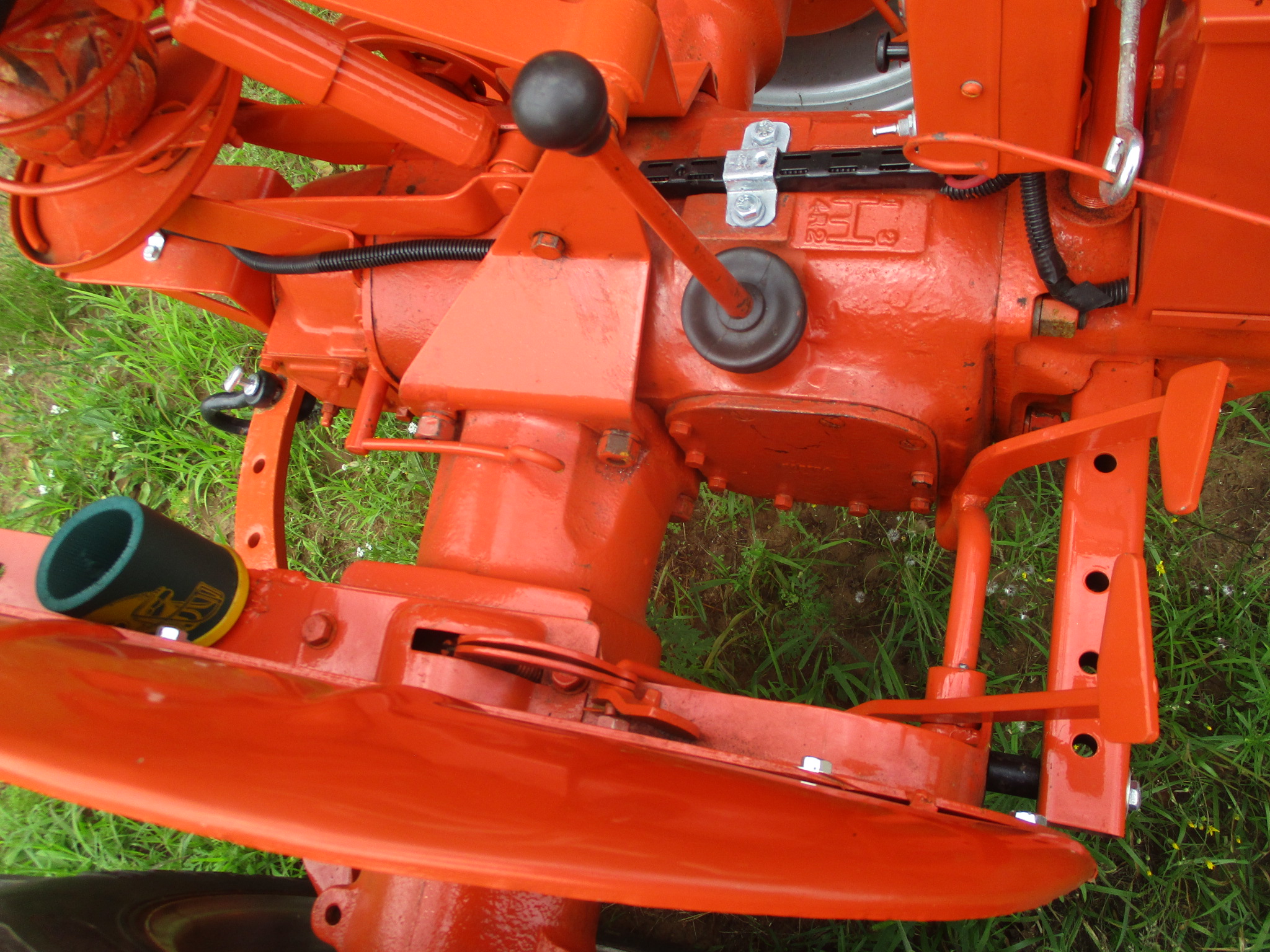

I have swapped a CA trans into a C tractor myself. Customer needed higher raod speed for tractor drives. I raced my WD45 with the C after the 4-speed conversion and I barely went faster at stock throttle setting.
It is a direct interchange EXCEPT FOR THE DIFFERENTIAL BEARING CARRIERS!! The B/C axle housings are smaller on the ID where they bolt up to the transmisssion. You have 2 options: Grind the inside of axle housing out so they slide over the CA carriers, OR turn the OD of the CA bearing carriers down 1/8" so they are the same size as the B/C carriers and the axle will bolt on without interfering. Can't remember what I did for the PTO housing.

Also I think the seat rails and footbars are different widths, at least the CA foot is a bent angle vs the B/C square box. The difference in the slant of the CA final drives is all in the axle housing. The B/C PTO will go onto the CA transmission if you use the B/C sliding drive gear. Johnny Cash will be proud of you Big smile
