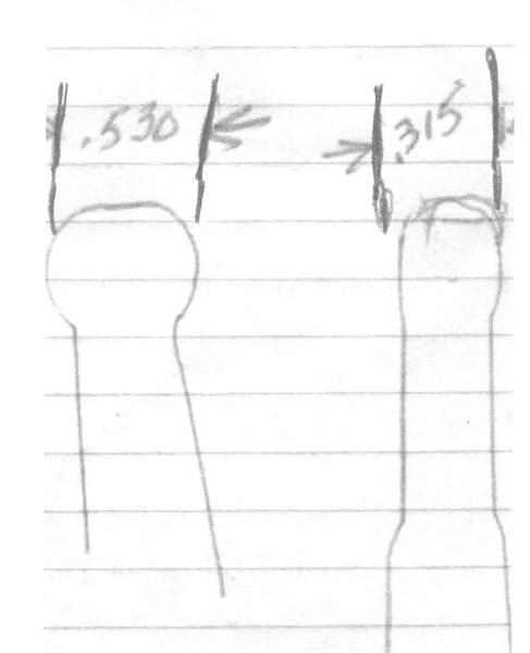

A few years ago someone posted on here a drawing with the measurements of the ball on the bottom on the bottom of the shifting lever. That is what usually wears and needs to be rebuilt. Maybe someone can find it and post it for you.

This was posted here years ago. I can't recall whether this is WD or WD-45 or both.

Think that was the constant mesh trans but probably much alike.
