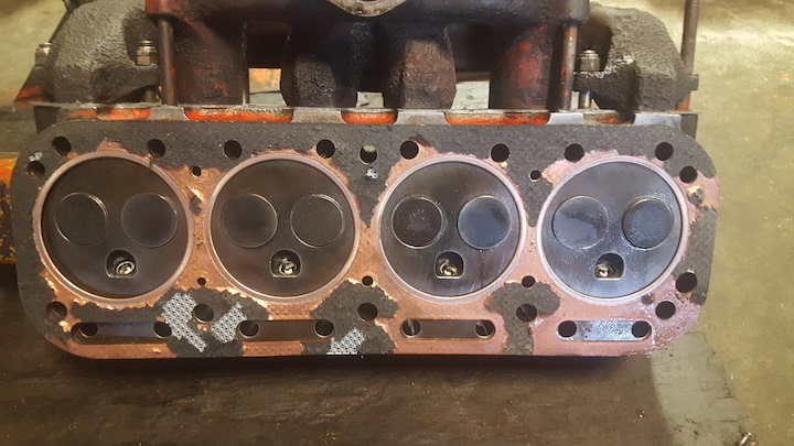

So pulled the drain plug this morning and first thing to come out was about 1 cup water. That was disappointing.
So we pulled the head back off and found a wet head gasket, that delaminated when we pulled it off. Best guess is coolant was wicking past gasket and on into the block. But we have also filled block back up to top to see if any coolant is getting past O rings of the sleeves.
Head gasket came with rebuild kit from Reliance. Rumor has it (now.....after the fact) those are suspect. So looking for a Fel-Pro replacement.

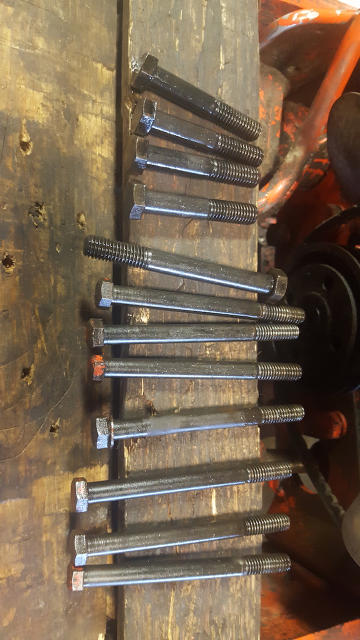

Main question, however is the head bolts, which come in two sizes. One group is 3/8".....4 bolts on right side are larger. My service manual shows torque for all head bolts to be the same.
Have been told that on the WD45 and maybe D17, same thing exists....head bolts are two different sizes but torque for those goes up. Is greater for the larger bolts.
What is the best plan for the D15? Leave them all the same or increase torque for the larger ones?

Just looking at the gasket, pathway coolant may have taken was lower left in photo.....from coolant channel to one or both of the slots used for the push rods. Just wicked through.....which is where it was wet and where it delaminated when head was pulled off. Where metal core of the gasket is showing.

Ive had same head gasket problems on a D17. You can identify the bad head gaskets by the following: the width of the steel fire rings on the BAD gaskets are the same width on both sides of the gasket.
The good head gaskets have a wide width fire ring on the block face, and a narrow width fire ring on the CYLINDER HEAD side. These bad aftermarket head gaskets started to hit the market last December from what i can tell. They do not compress enough under torque to seal. This, in combination with too much sleeve standout from aftermarket sleeves causes coolant leakage! Anywhere you see copper still showing on the gasket means it did not seal under torque on those areas!

All head bolts on ALL of the 138/149/160 engines are the same diameter on all engines, just 2 different lengths. The smaller 3/8" bolts hold the rockershaft.
 The gasket should have "This Side up" embossed on it.  It really isn't possible to get it on wrong as there is a long and a short distance from the bore to the edge of the block front and back.
modirt View Drop Down
Joined: 18 Jul 2018
Location: Missouri
Points: 8994
Post Options Post Options   Thanks (0) Thanks(0)   Quote modirt Quote  Post ReplyReply Direct Link To This Post Posted: 22 May 2021 at 8:33am
As I study the bolt pattern again, PaulB is correct. Only one way to put the gasket on.
As for the bolts, 4 are shorter, but are also larger. This is the 160 engine.

If you have a mix of 7/16" & 1/2" head bolts on a 160CID engine, you must have the  Red Headed Stepchild that snuck past the QC at the engine plant.  Every 160 CID engine I've ever had apart as well as the 2 empty NOS 160CID blocks I have, all have nothing but 1/2" head bolt threads. Now the 149,138, as well as the BE & CE engines have a full set of 7/16" bolt from what I've worked on. Yes there are long bolt to one side and shorter bolts to the other side.
Points: 5317
Post Options Post Options   Thanks (0) Thanks(0)   Quote AC720Man Quote  Post ReplyReply Direct Link To This Post Posted: 25 May 2021 at 8:46pm
That’s not true, our D15 series II has never been apart and it had 2 different size head bolts when we rebuilt it 2 months ago. I know, I torqued the head with 2 different sockets. The head bolts were removed and placed in a piece of cardboard as they were taken off, marked front and rear and with the proper alignment of the bolts of the head.

My 64 d15II head had 7/16” and 1/2” bolts too.
Points: 5192
Post Options Post Options   Thanks (0) Thanks(0)   Quote PaulB Quote  Post ReplyReply Direct Link To This Post Posted: 26 May 2021 at 6:18am
Maybe there was an update at some point that increased the size of the 7/16 to 1/2. As I mentioned I have 2 NOS blocks that have never been used, that a 1/2" bolt fits all holes. I've also have a few other 160 engines apart that had all 1/2" head bolts. I've never encountered a 160 engine that had a mix of sizes for head bolts.

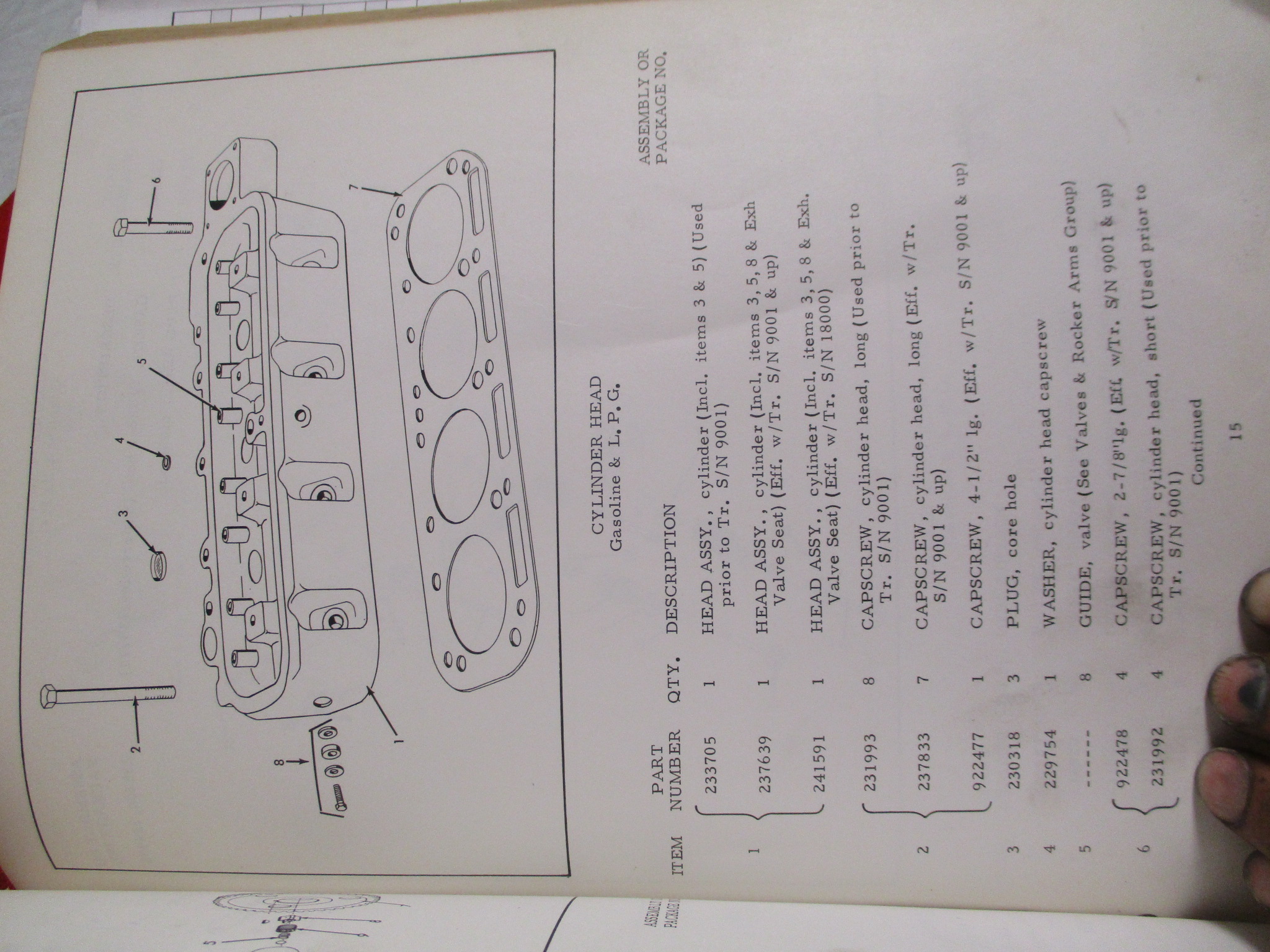

So imagine our frustration when we uncork one that does have a mix of bolts. And even the parts book is no help......they only mention various numbers.....some lengths, no sizes.
But since this engine does have a mix of bolts, we are leaning towards borrowing the concept of giving the larger bolts more torque, same as is done on other AC engines where there is a mix of bolts. The question will be how much.
Another thing that is a puzzle.....how we found it and as shown in the parts book. ONE....and only one....head bolt / cap screw has a washer under it. Why is that?

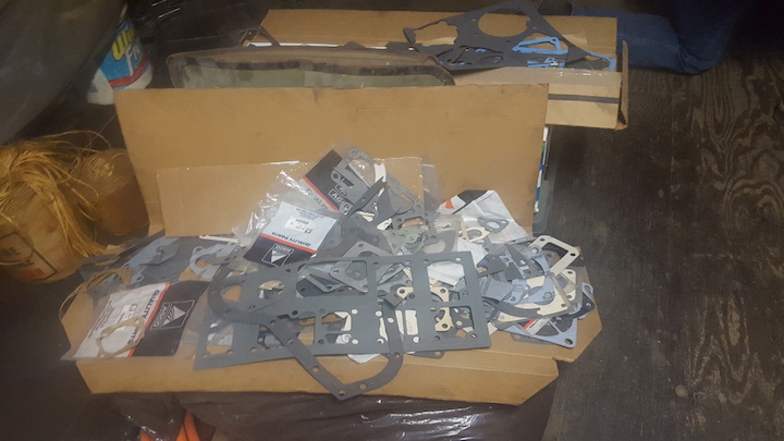

Replacement head gasket ordered through a local supplier. Gent who is about 80 dropped off a new Fel-Pro gasket. He happened to be the same guy who was trusted to turn down the crankshaft, and is well respected by locals when it comes to engine rebuilds. He is the man.

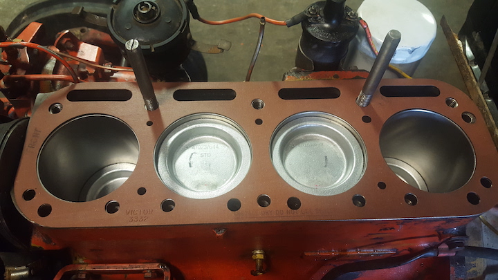

However, before that showed up, as luck would have it, a pair of alternative head gaskets showed up in shop where wrenching is taking place. Should probably mention that the building is about 45 years old and has been used almost exclusively as an AC repair shop. On any given day, there are from 6 to 8 AC tractors in there in various stages of undress. Currently holding a C, pair of 185's, pair of 190XT's a WD and a 7010.....plus a D15. While sorting through one of several piles of various surplus gaskets, two different Victor head gaskets showed up. No clue as to their origin or history, but there they were.
One is what is believed to be similar to what she was wearing when she left West Allis.....thin and no fire ring. Alternative was a thicker Victor with ring.
When gent who brought new replacement in saw the Victors, his mood improved. Said at one time they were A#1 first choice if you wanted the best. Would be using those if it was his......and no sealant. Says so right on the gasket. He confirmed that was right.

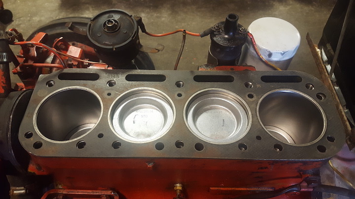

So thicker gasket with fire ring went in, no sealant, smaller bolts torqued to 80 ft pounds, larger bolts to 90 ft pounds and that did it. Held head water for about 5 days with no leaks, so buttoned her up and she is now back together and running.

Pile of gaskets were replacements were found. Lucky to have access to such parts.....
And for future reference.......part number for the gasket used was Victor 3145. Those can be found on ebay and a few other places. Now sold under the name of Victor Reinz. Not sure if quality of those is still the same as the one we used.
Have heard from a few sources that the head gasket included with the Reliance rebuild kit is suspect. If that one is used, I might suggest putting some water in the block and head after torquing it down to test it overnight before going much further.
