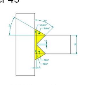

the shaft does not necessarily need to be ground to a POINT.. it could be about 1/4 inch flat on the end... Your weld will burn in and take care of most of it..  The "yellow" is the weld in this drawing.. Shows how to grind ONE PART at an angle and the OTHER part FLAT. ..... they left a FILLET in the weld on the shaft. You might not have that option... might have to grind flush with the shaft to get assembled.
