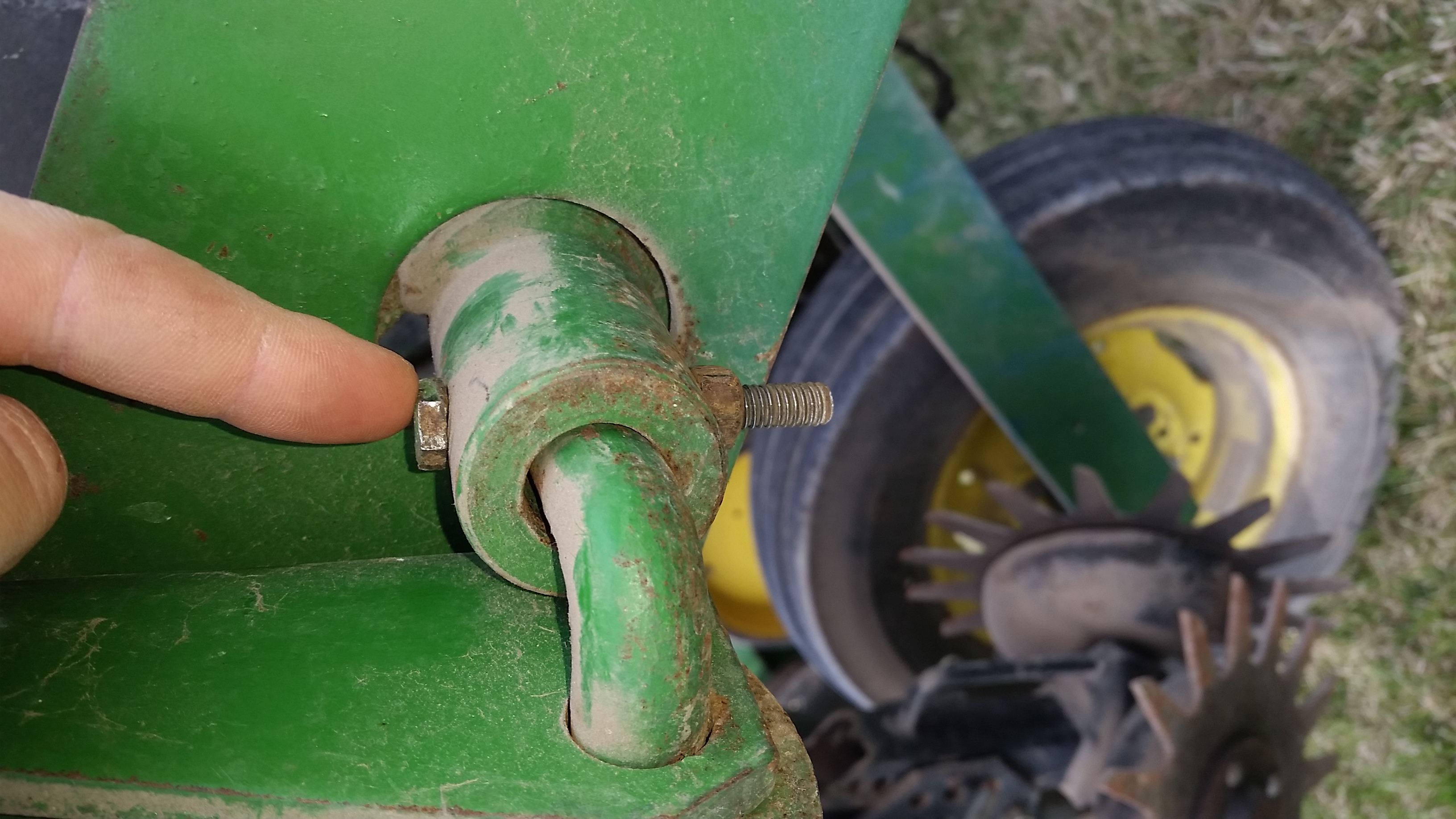

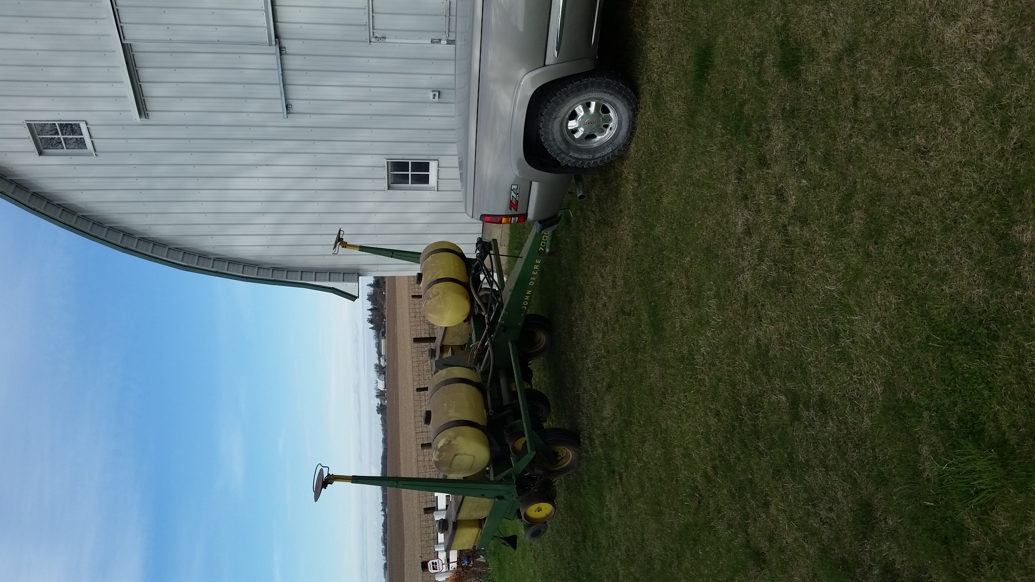

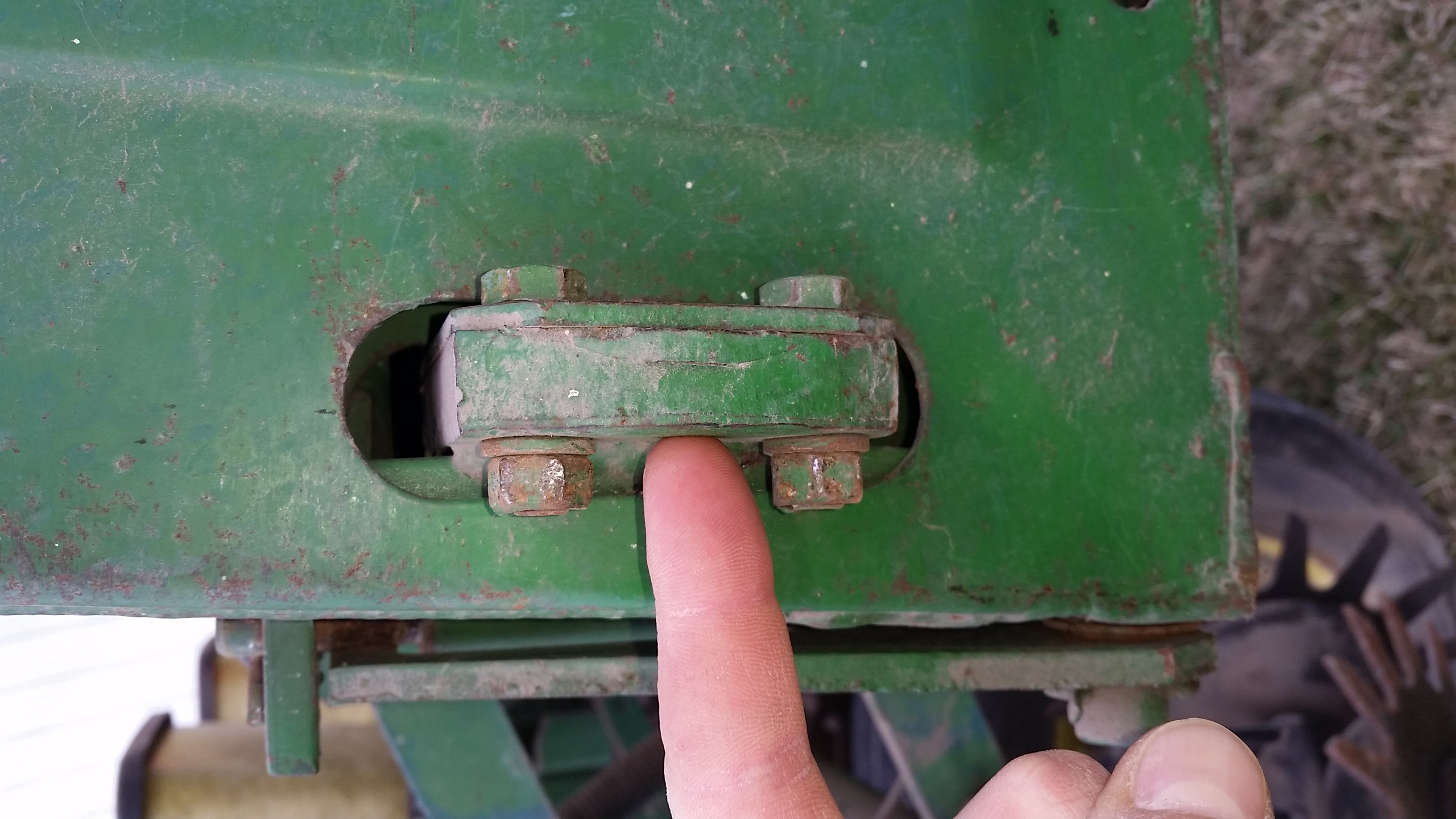

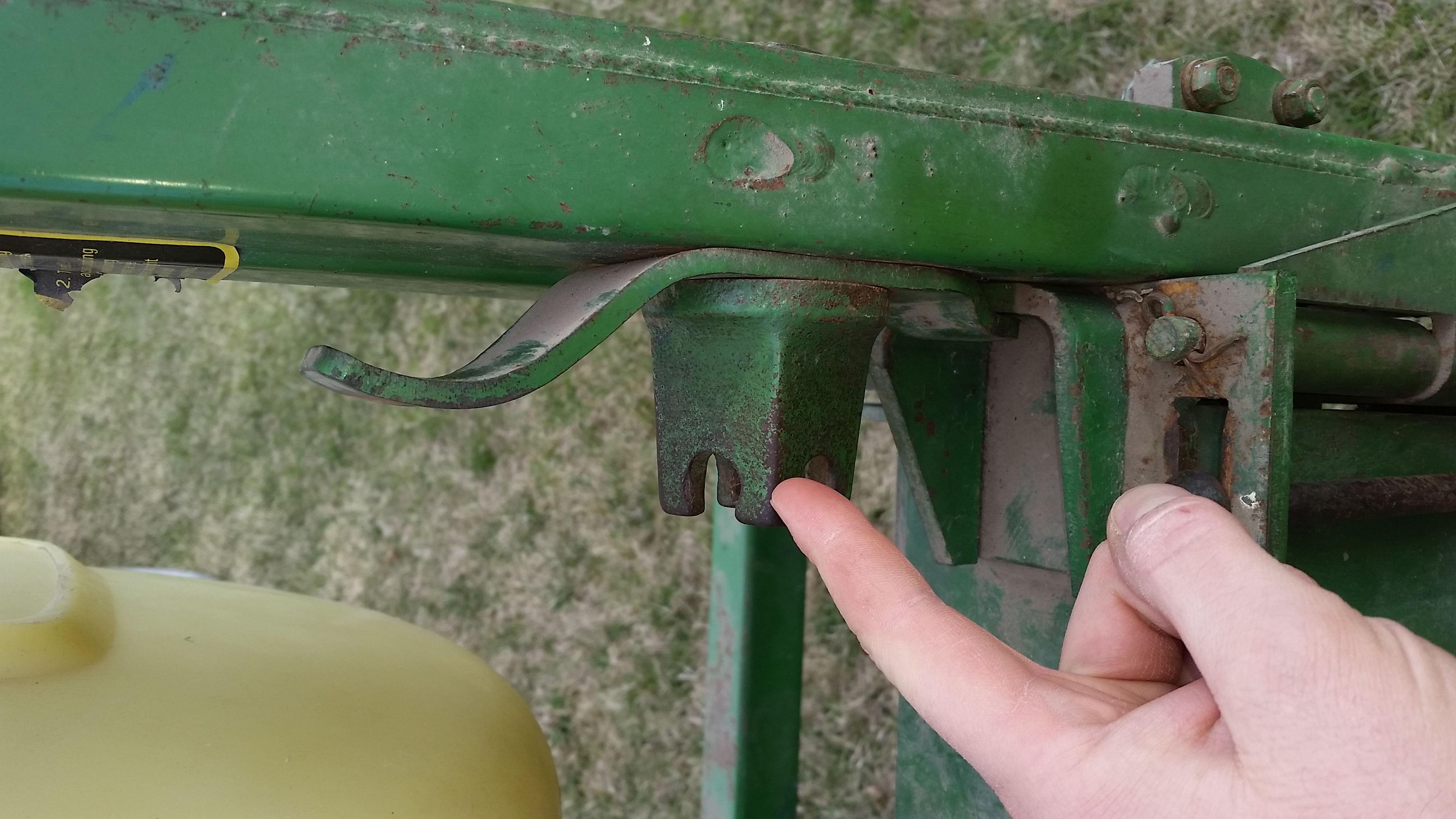

I was going to add pictures but can't seem to figure out how. I took off 2 bolts on outside of marker. Removed a bolt from the 90 degree "marker rod holder?" And that allowed it to lower and swing back for storage. Ow and also looses the transport holder on back of marker arm. Thanks for the help, it's my first planter so this won't b the last question I'm sure lol. Says my picture size is too large, I tried lol
1955 WD-45 with factory PS
