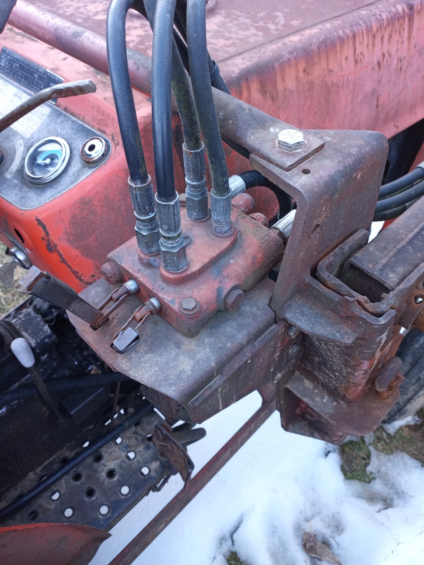

Does anyone know what size the ports are on the 5020 loader hydraulic valve?
I pulled a line off last night;  they are smaller than 3/8.  I'm thinking that maybe they are measured in sae size.  The SAE 2 size is equal to 5/16...anyone know?

metric would be my first guess

I think it’s -6 orb

-2 SAE would be 1/8. -6 is 3/8 which is 9/16-18 thread. 5/16 would be -5
