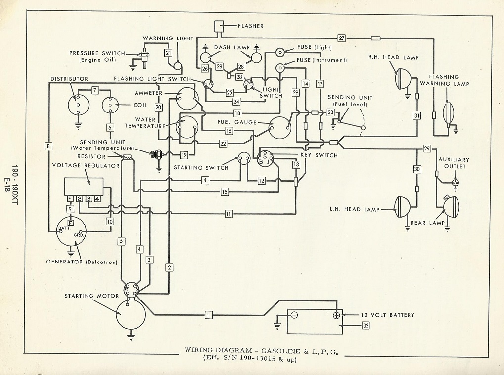

So my lights work. I've cleaned grounds, checked continuity, etc. All of them work, except the flasher that is unplugged. However, whenever I put it into gear and start moving the fuse blows. Only the light fuse. Simply putting it into gear doesn't cause it to blow, but when I start moving is when it happens. I've tested this twice, successfully (in a bad way?).
I'll attach a picture of my wiring diagram.. But any ideas what might be causing this?
Also, I cannot for the life of me find this "Auxiliary Outlet" shown on the far-right side of the diagram.. Can anyone direct me too where it might be? If it matters, I have a cab on my 190XT.
Thanks in advance everyone!

Fantrum, the AUX outlet would be back by/under the tail light on the left fender.  It would be a spring loaded flip lid with two prongs inside.

Thank you for the information on the aux outlet! I definitely don't have one there, so I guess someone removed it however long ago. I suspected as much, but it's nice to confirm it, so thank you.

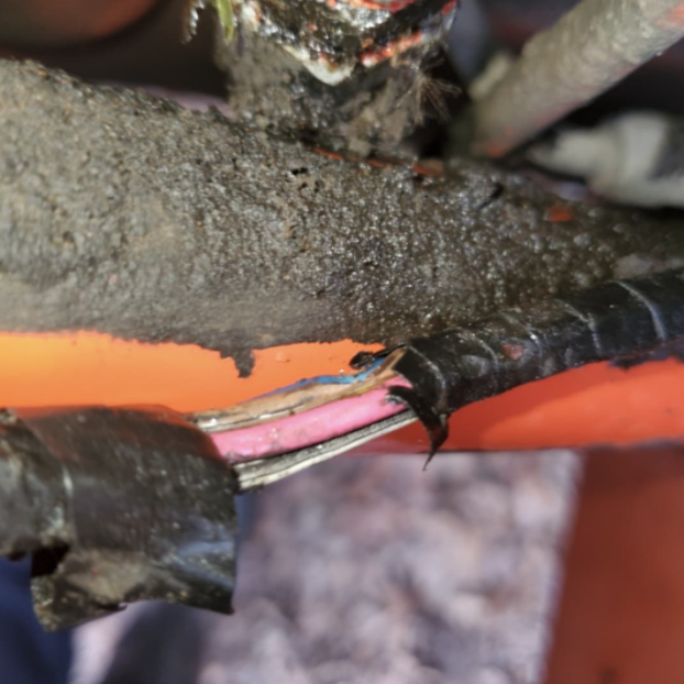

The fuse only seemed to blow when I stepped off the clutch after putting it into any gear. I assume this was jarring the wire and causing it to connect with the frame.
As far as the exposed wiring.. I found it! Decided to do some investigating today while the kids and wifey were napping and actually managed to find it. I disconnected both lines for the lights, which only left the dash lights/switch(es) connected and it still blew the fuse, so I worked forward from there and found it relatively quickly behind the left side-panel. It had managed to wear through electrical tape and the wire coating and was rubbing on a frame rail I suppose.
Patched it up and tested it out with 100% success. Hopefully I'm not unlucky enough to have 2 areas, ha!

Glad to see you found the problem.
Maybe wrap some extra insulation around in that area, like slitting a hose and slipping over the wire harness.
Thank you for posting what you found.

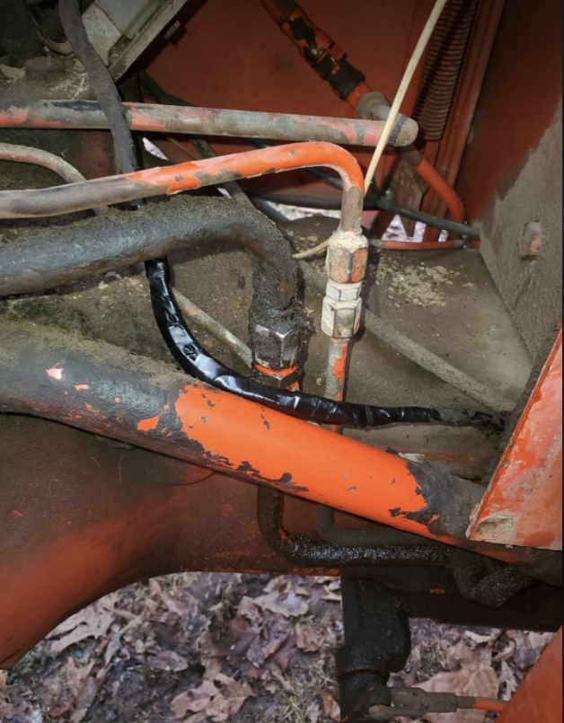

Happy you FOUND it ! That's the hard part, fixin is easy...
You may want to add a length of 'rubber hose' over that section of wiring. It'll keep the wires from shorting out in the long term. I suspect years of vibration caused the problem.
I've used rubber garden hose, clear vinyl tubing, etc. in the  past. usually 6-8" long, slit lengthwise similar to 'plastic wirewrap' but tougher.
BTW those hydraulic lines look 'weepy',might be a god time to clean them check those fittings.Have no idea what they're for but if they leak...dang, your pretty repair will look messy !

I layered it up as best I could with what I had on hand, but next time I'm at the hardware store I'll grab something extra. Good advice, thank you!
Also good advice on the hydraulic lines! I'm running out of projects, so perhaps that will be among my next!
