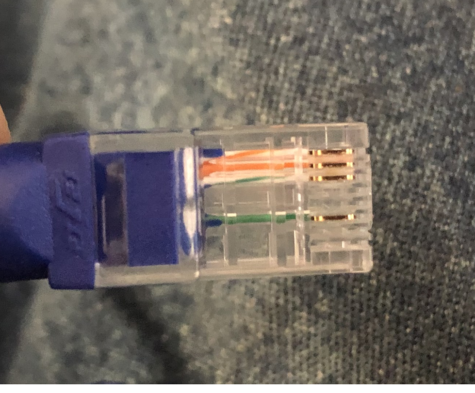

I have narrowed it down, the thing is, only 2 phone wires coming in, router has 4, I figure only 2 are used, I just need to figure out which 2.  I have an idea using the SWAG factor.  Here is a pic of the Cat 5 cord to the router.

The two in the middle that are GONE are the  BLUE and WHITE.... Pair #2 are on each side of them GREEN / GrWHITE ... Pair #3 in on the end ORANGE/ OrWHITE ...Pair #4 is GONE on the opposite end...
It is either ORANGE/ OrWHITE ............. or GREEN/GrWHITE...
the SOLID ORANGE or GREEN matches to the phone RED... the mate WHITE is the Green phone wire
Edited by steve(ill) - 13 Feb 2021 at 6:29pm

My guess was; Orange Cat5 to Red phone line and Green Cat5 to white phone line.  I will open the box on the side of the house tomorrow and give it a shot.
Points: 89209
Post Options Post Options   Thanks (0) Thanks(0)   Quote steve(ill) Quote  Post ReplyReply Direct Link To This Post Posted: 13 Feb 2021 at 6:49pm
it should be wire in PAIRS... The WHITE STRIPE wire goes with the mate SOLID wire.
