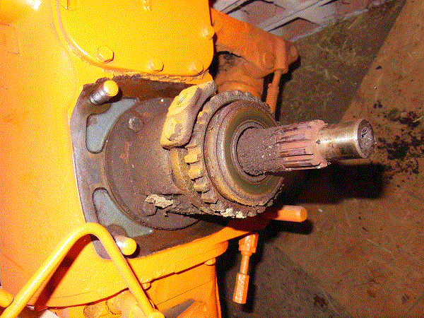

All parts on this 1951 CA refurb have been rusted and corroded - appears the hand clutch is no exception.  I have the final drive housing removed (see pictures) and have several questions I hope someone can help me with.
Bearing/Hub/Actuator/Retainer/Actuator Support
  1. How do I remove this assembly from the differential?
  2. Will the entire assembly come off in one piece if I remove the Actuator Support bolts?
  3. Will a gear puller help pull this off?
  4. There is a lot of corrosion between the parts - could a good cleaning free things up?  Or is there something else causing the clutch to be frozen?  I do not see any evidence of anything purposely bolted tight (or welded together) to keep the clutch from slipping.
Clutch Assembly
  1. How do I remove this assembly from the housing?
  2. Is the clutch assembly bolted to the brake drum?
  3. Are both of these removed from the housing as one unit?
  4. Do I need to remove the brake shoes before I can remove them?
  5. I assume everything is rusted up - any hints on all to break this free from the housing?
  6. How can I determine if the clutch needs to be refurbed before I reassemble everything?  I would rather not tear this down again if cleaning up the Actuator parts does not get the hand clutch working properly.
Thanks for any information you can provide

If you’re wanting the hand clutch out, the actuator you pictured still bolted to the tractor has nothing to do with removing the hand clutch, although Iit needs to come off to be sent to the rebuilder, I think it only has 2 bolts and it will come off.
Now the hand clutch is inside the final drive just slipped on a shaft with a key way to keep it from slipping.   They can freeze to the shat and be a bear to get off, penetrating oil and pry bars to remove, you might make some kind of puller to get it off, but not much room for that , and could hurt the hand clutch.
The clutch is bolted to the brake drum but needs to be removed as a unit. It may be frozen too the shaft pretty badly, but they can usually be removed with patience and perseverance.
As the previous poster said some people bolt the clutch plates to the assembly so there is no way it can slip. Still doesn’t change the removal process, but I’ve seen several bolted together.
   Some people that also have no need for the clutch swap in a left axle and leave the clutch out of the tractor all together.
   As far as the brake shoes, go ahead and take them off, probably need new ones anyway, and it may give you more room to wiggle the clutch out.
I recommend sending it too Rick for a rebuild after it’s out, it will slide out, just may have to work on it a few minutes every day.
If you don’t need the clutch bolt the disc and drive together and no more worries, but a lot of people including me really like the second clutch for mowing and such, if it was mine I’d definitely get it rebuilt.   Get a good job and it’ll probably last as long as you have the tractor.    I have 2 CA’s and couldn’t imagine not having the extra clutch. But it’s up to you and what your gonna do with the tractor when it’s done.
Good luck with it , and I would for sure send it to Rick to get fixed, maybe even call him for removal help. I’ve only taken 3 or 4 out, I bet he’s done a whole bunch more. He is a wealth of info on them and whatever he says is what needs to be done.
Keep us updated.

Trying to come up with Plan C to remove the hand clutch/brake drum assembly from the Shaft inside the Final Drive Housing.  The assembly seems to be rusted in pretty good - prying, lubing, heating and whacking hasn't worked.  Gear puller wouldn't work.
Looking at the parts illustrations, it seems like I should be able to remove the Cover/Gaskets/Bearings from wheel end of the final housing and drive out the combined Shaft/Brake Drum/Hand Clutch - nothing in the illustrations show anything mechanically attaching it to the housing (or to the axle Gear).  However, something must be holding it or else it should have moved when prying on the brake drum.  Can anyone describe what is holding this in the final drive housing?  Do I have to first remove the Axle and Axle Gear?
I'm thinking that if I can remove the Shaft with the Clutch and Brake Drum,  I can better direct the MAP torch heat to get the shaft separated.
The Actuator Assembly came off easily as described by DaveSB.  Took off two bolts, then used gear puller (although it probably would come off by whacking with 4 x 4).

I PM'ed Steve (ill) to ask more about how he removed the clutch/brake drum from his model B.  I am wanting to try his method of driving the shaft out thru the cover plate, rather than pulling the clutch/brake drum out with a pry bar in the opposite direction - which hasn't worked for me.
Apparently the model B has a set screw holding the shaft in the housing, while the model CA has a snap ring.  You can see this in the CA drawing that Steve posted on Feb 12.  #53 is the snap ring behind #54 bushing.  When I look through the final drive housing drain hole under the brake drum in my CA, I cannot see the snap ring nor can I feel it with a dental pick.  I originally assumed that this snap ring went missing years ago as it is obvious that the final drive housing has been removed many times before (the mounting nuts are rounded over).  But I would like to make sure so I don't damage anything when I try to drive the shaft out with a sledge (Steve said it takes about 50 strikes with a sledge because of all the rust and crud).
Does anyone have experience on this with a CA?  If the snap ring is present, is it obvious to see?  Can it be hidden under the #54 bushing?  If the snap ring is there when I drive the shaft out, will it break free without doing serious damage?

Post Options Post Options   Thanks (0) Thanks(0)   Quote Alex09(WI) Quote  Post ReplyReply Direct Link To This Post Posted: 05 Mar 2021 at 2:22pm
Snap ring is not holding the clutch unit on the shaft. Snap ring is on other side of shaft to prevent clutch from sliding too far on shaft. Remove axle end cover and stick a long solid punch through the clutch onto the end of the shaft and hammer/press away. Will need to replace axle seal as keyway will take it out when shaft comes out.

Alex09-
Should I be concerned about the snap ring damaging the brake drum as I punch the shaft through?  I can't see the snap ring, but it might be hidden from view.  Or it might have been removed or lost long ago.

No, snap ring will not damage anything.

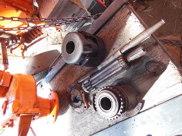

I finally got the CA hand clutch/brake drum assembly removed from the final drive housing.  I'm including some of my notes as Ted J requested.
Since I could not pry the assembly out, I drove the shaft out the other direction after removing the end plate (as suggested by Steve and Rick).  This took me quite a few weeks while I kept the shaft soaked with penetrating oil.  It finally came out relatively easy once I wedged in some steel plates between the brake drum and the final drive housing.  I think the problem was that when I was trying to drive the shaft out, it had no hard resistance until I inserted the steel plates.
I found no evidence of the snap ring shown in the Parts Illustration.  It did not have a set screw as Steve noted for the Model B.  I did remove the new brake shoes I put in last year - so these came out easy this time.
I bashed the end of the shaft pretty hard with my home made drift (two 9" blacksmith round tapers connected with three-quarter inch plastic electric conduit).  It did not seem to damage the end of the shaft.
I bought a $60 one ton HF chain hoist which made handling the heavy final housing much easier.
The picture below shows the clutch/brake drum assembly (top) and the actuator (bottom).  In the middle is the shaft with the large key.  Also shown is my redneck home made 18" drift.

Dale,
 Some of these things are a challange. I have never had one of these apart yet. Thanks for the pictures and details. Yea the 60 years of rust and crud are not considered in the manuals! Good job getting it apart with minimal disruption!
